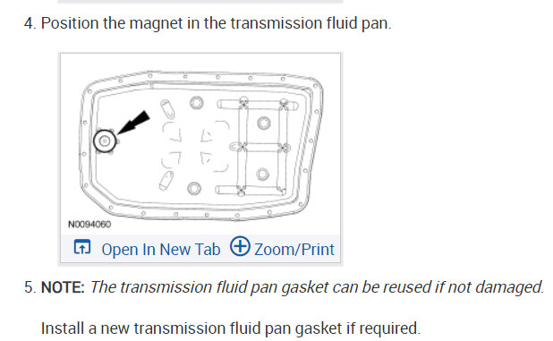

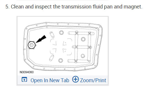

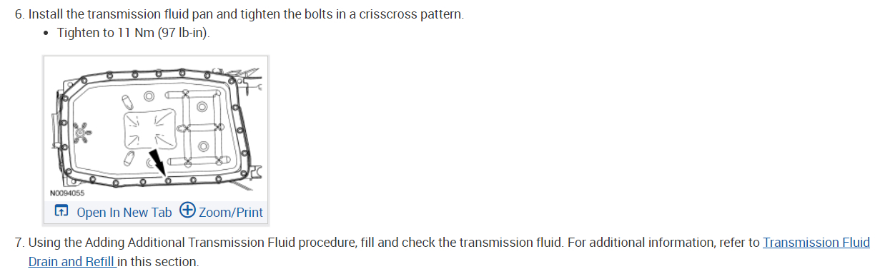

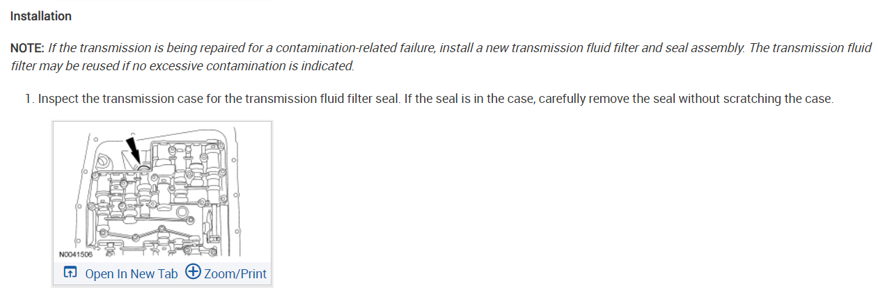

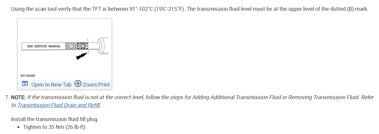

I want to change transmission oil with filter and gasket, getting a lot of different advice on this. What’s the best way to do it? I have all the tools, but mostly I want to know the risks if there is some.

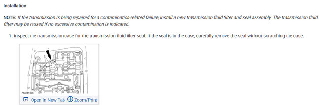

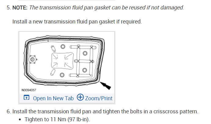

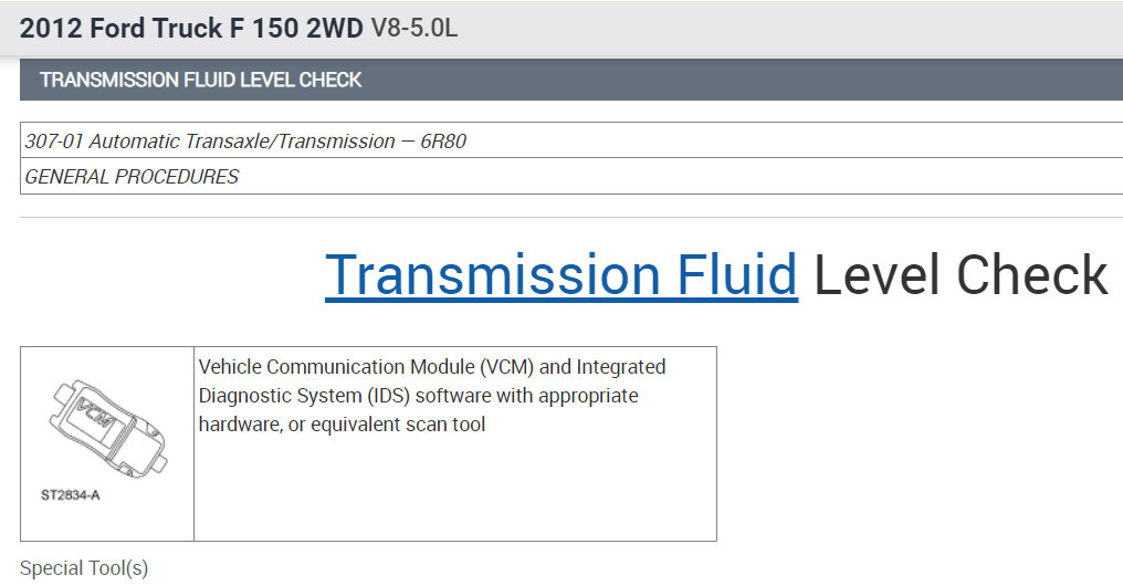

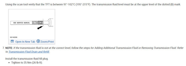

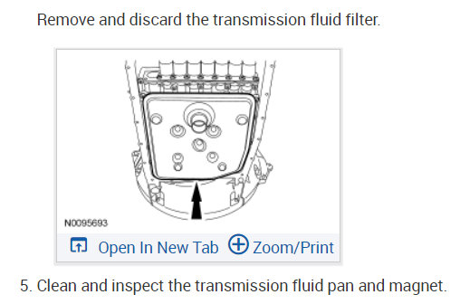

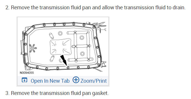

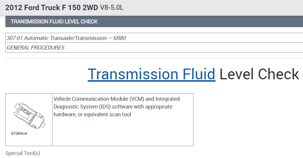

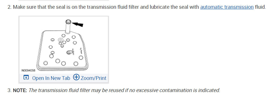

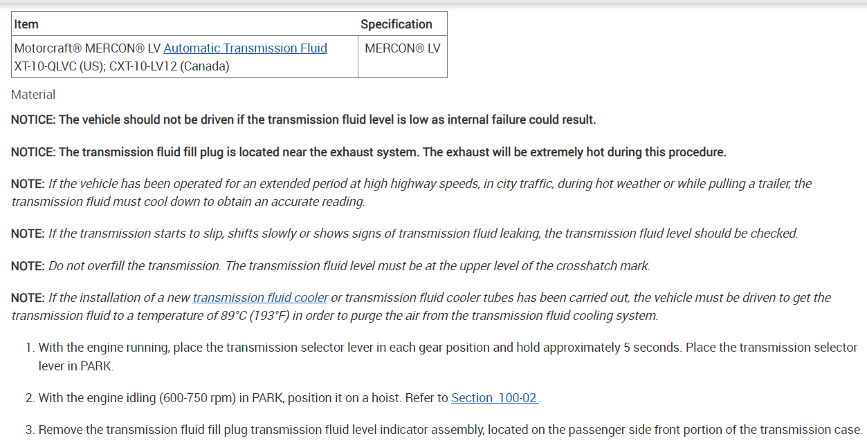

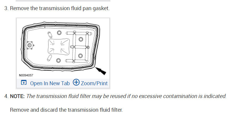

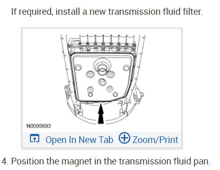

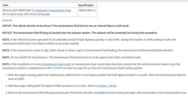

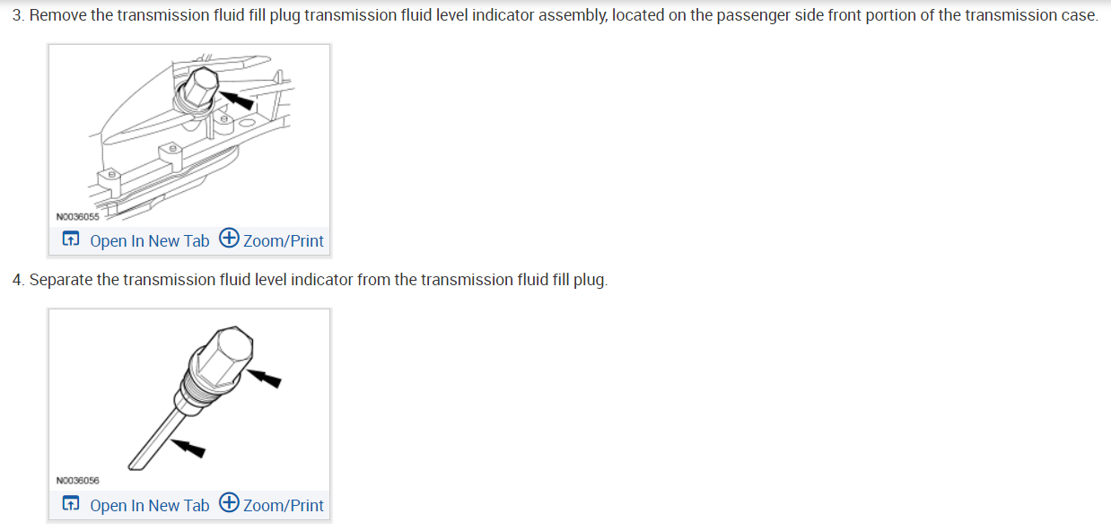

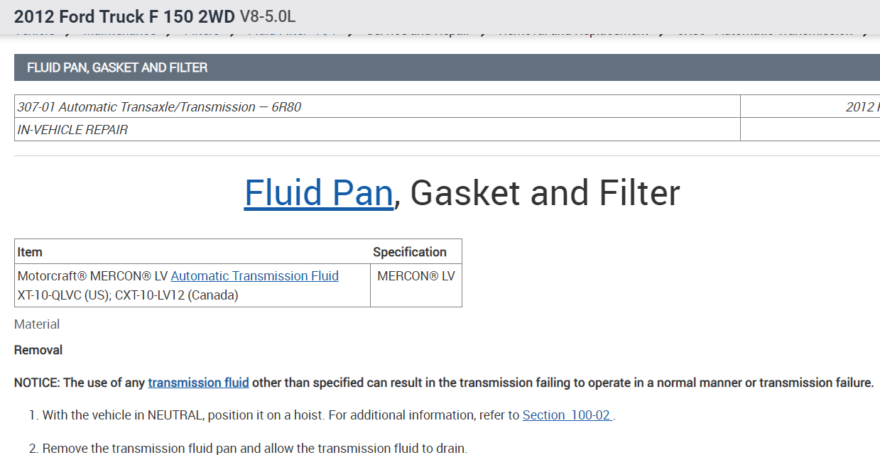

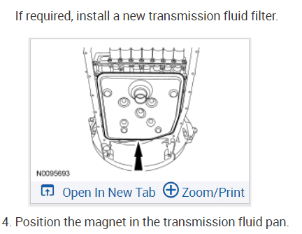

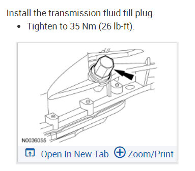

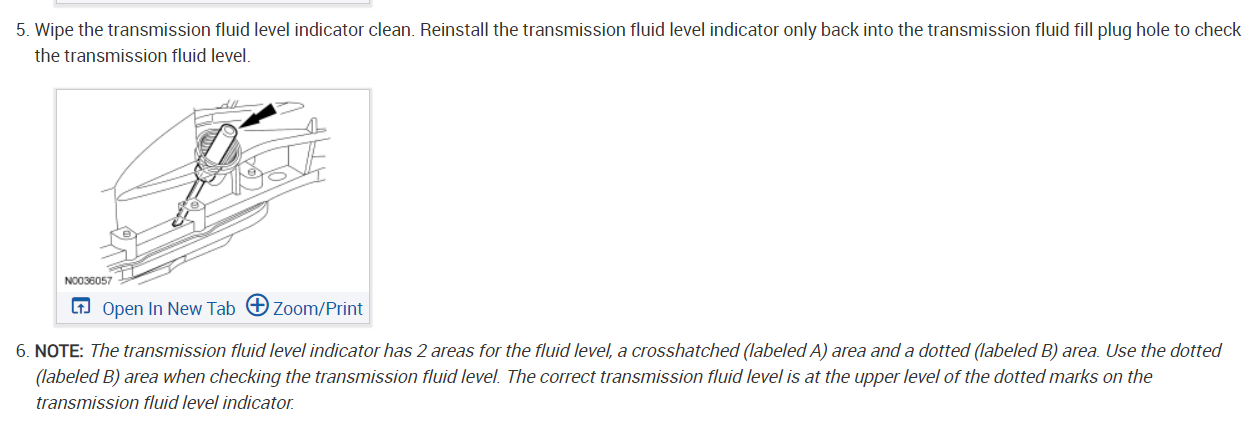

It is a good idea to service the transmission and filter. Some say don't do it if the transmission is old, but I will tell you want will ruin the transmission that is a clogged fluid filter. Here is a generic guide to help you step by step with instructions in the diagrams below to show you how on your car:
https://www.2carpros.com/articles/how-to-check-and-add-transmission-fluid
Fluid Types
Automatic Transmission Fluid
Ford Part Name
- Motorcraft MERCON LV ATF
Ford Part Number
- XT-10-QLV
Ford Specification
- MERCON LV
NOTE: Automatic transmissions that require MERCON LV should only use MERCON LV fluid. Use of any fluid other than the recommended fluid may cause transmission damage.
Capacities
Automatic Transaxle
6R80 .................... 13.1 quarts (12.4 liters)
Check out the images (below). Let us know if you need anything else.
