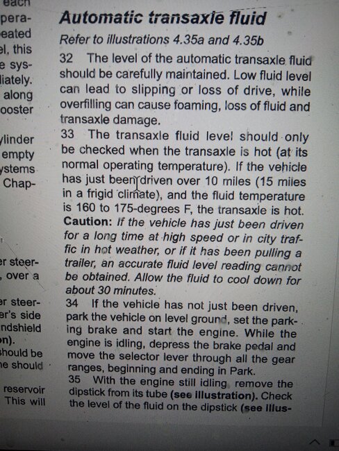

is there any temperature the transmission fluid level should be checked at? I read somewhere on the net it should be checked when fluid temperature should be between 160 and 175F, is it right? any info on all data?

confused now. The transmission dipstick has hot and cold marks, each one of them has min and max. So, do you mean by warm the cold mark? Also, when you say warm are you talking about the engine coolant temperature or the transmission temperature? This is what i read in the Haynes manual. please see picture.

There is conflicting information about this, I would drive the car, or just start the engine and allow it to get to operating temperature and then check the fluid level.
