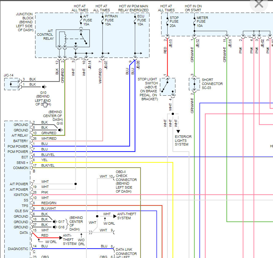

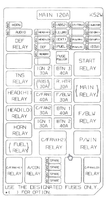

Where is the Transmission Control Relay?
Friday, July 26th, 2019 AT 9:38 AM
MECHANIC
18,907 POSTS
Hi Ricjo923,
Attached is the wiring diagram and a breakdown of the engine compartment relay box. Looks like it is on the left side called the TNS relay.
Let me know if you need more info. Thanks
