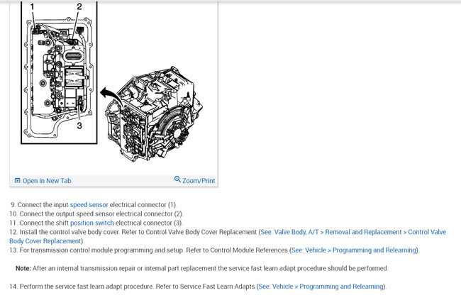

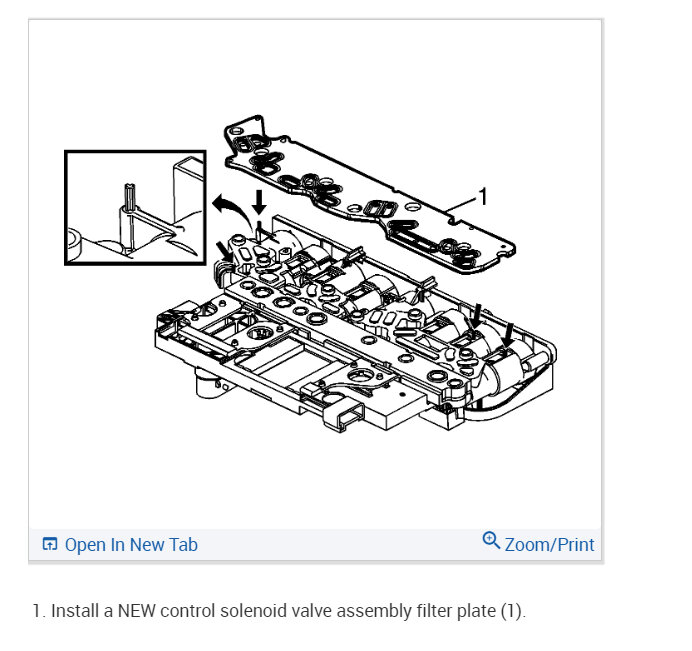

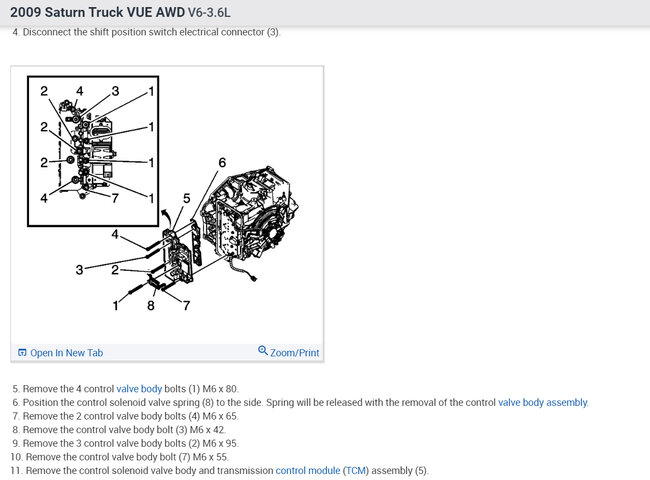

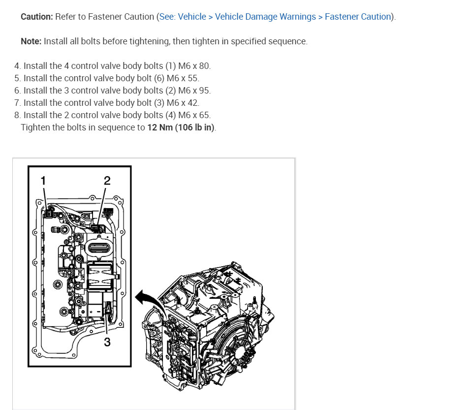

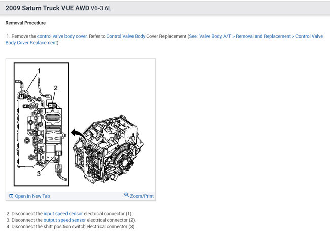

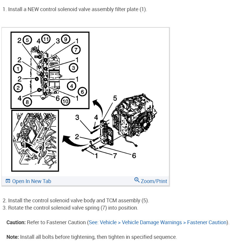

Transmission control module location?
2009 SATURN VUE
10,000 MILES • 3.5L • V6 • 2WD • AUTOMATIC
TMS138

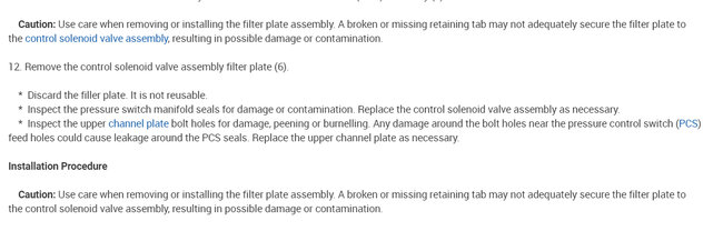

I need to replace the TCM but I am unable to locate on my vehicle. I have searched the internet for days and can not find answer, hoping someone can guide me.
Thank you
Jul 21, 2019 at 12:07 PM
  • 54,520 POSTS
It looks like it is inside the transmission here is how to change the TCM out. Check out the diagrams (Below). Please let us know if you need anything else to get the problem fixed.
