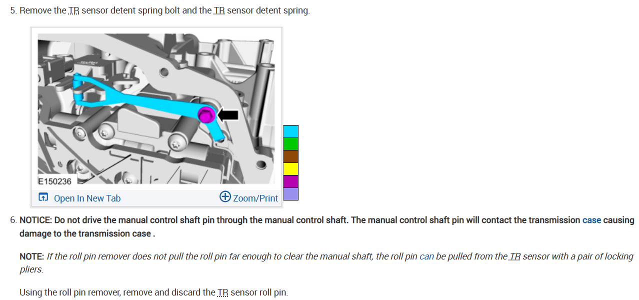

So I assume the engine is not cranking over (starter operation), correct?
P0706 - Transmission Range Sensor "A" Circuit Range/Performance
P0707 - Transmission Range Sensor "A" Circuit Low Input

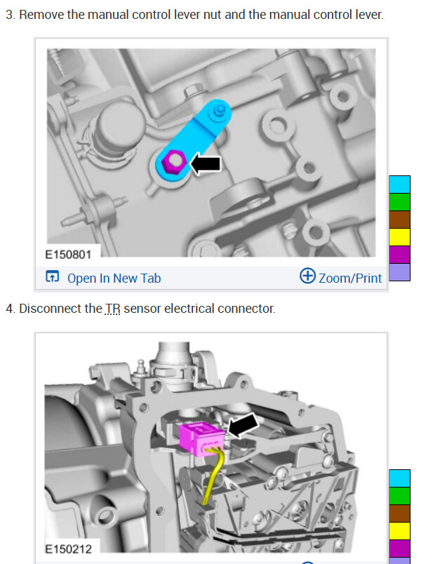

This is a big problem with these cars, unfortunately Ford thought it would be a good idea to put the switch/sensor inside the transmission instead of the easier external switch/sensor. You will need to remove the transmission pan and the selector shaft to replace the gear range sensor. Here is an image of its location, this is the second time today I have given this answer. :/ There are special tools involved as well, let me know if you need the complete instructions on the repair. Check out the images (in blue - below). Let us know how it goes.

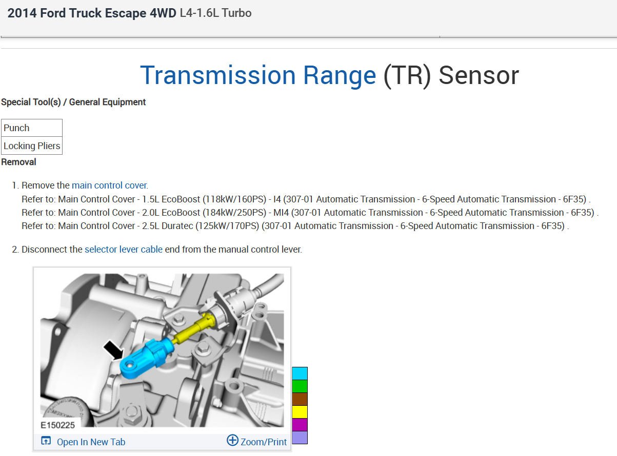

The U0401 - Invalid Data Received from ECM/PCM "A" could be a side effect of the bad gear range sensor. Here is how to replace the unit, check out the images (below). Please let us know what happens.

Do you know what that tool to get the roll pin out is or how I can get it out. I’m stuck on this
Tuesday, May 13th, 2025 AT 1:41 PM
KEN L
  • MASTER CERTIFIED MECHANIC
  • 55,488 POSTS
Yep, this is a specialty job and people have had problems with it. Can you upload images so I can see what you are stuck with?

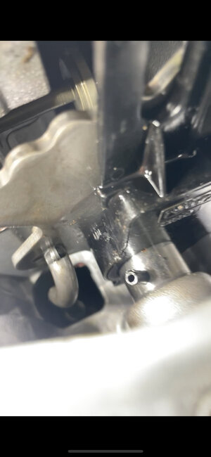

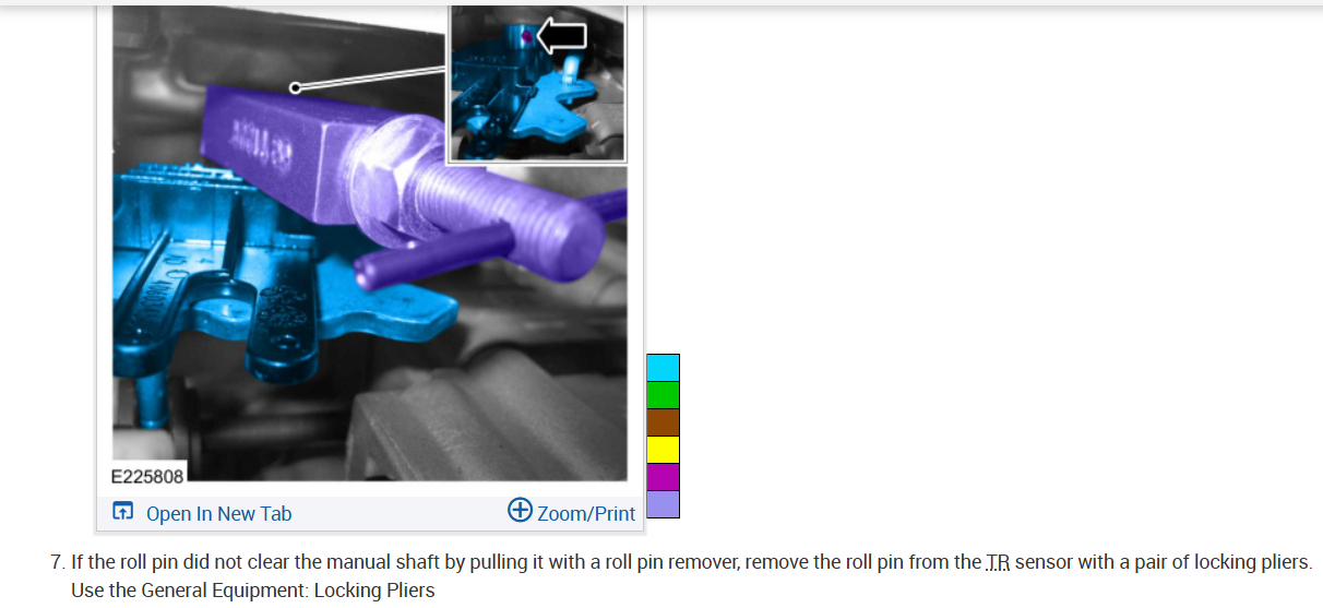

Yeah it’s that small roll pin and the shaft to the left of the photo.
Wednesday, May 14th, 2025 AT 10:55 AM
KEN L
  • 55,488 POSTS

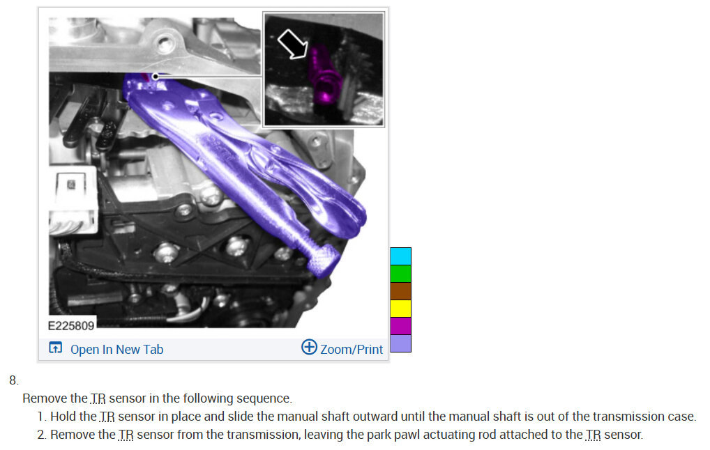

Thank you, can you grab the roll pin with a pair of needle nose vise grips?
Wednesday, May 14th, 2025 AT 11:02 AM
BRADY15071
  • 12 POSTS
I’m trying to change it with the transmission in the car and there’s not much room. I can get vise grips on it as tight as I can but it just slips off when you try prying it out or wiggling it out.
Wednesday, May 14th, 2025 AT 11:03 AM
KEN L
  • 55,488 POSTS
I see in the instructions there is a special tool to push the pin out from the backside, is that what you used to get it out as far as you did? And If so, can you work the pin further out with the tool?
Thursday, May 15th, 2025 AT 9:40 AM
BRADY15071
  • 12 POSTS
No I don’t have the tool. I’m trying to find the tool but there isn’t any information on it. Do you know what it is?
Thursday, May 15th, 2025 AT 5:20 PM
KEN L
  • 55,488 POSTS
It is the transmission locking pin removal tool, I would call the dealers parts department to see what they say.

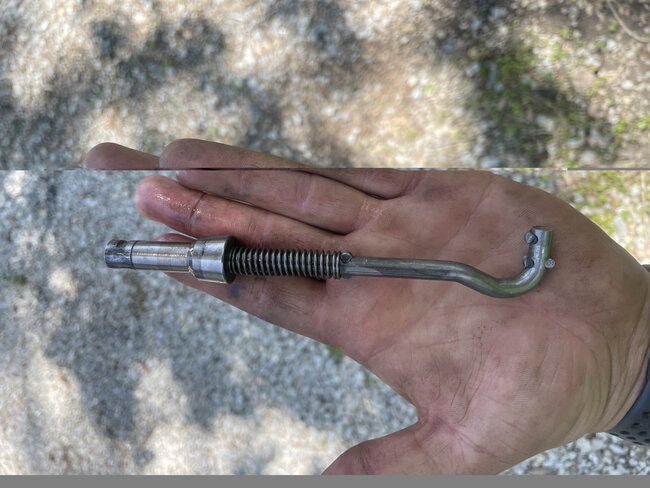

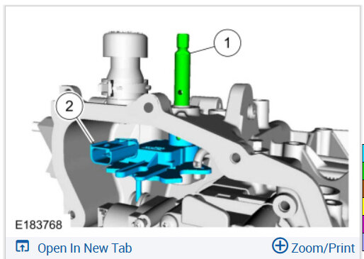

I got it out but What does that shaft connect too on the side. When I got the sensor out you have to spin it to get a shaft off and the whole shaft came with it. Does it just slide back in or is that a bigger problem?
Friday, May 16th, 2025 AT 10:48 AM
BRADY15071
  • 12 POSTS
This is the shaft that came out with it.
Friday, May 16th, 2025 AT 10:57 AM
KEN L
  • 55,488 POSTS
Hmm, it does look like anything is broken, I would change the in the new replacement part and reassemble, be sure to clear the codes once completed.
