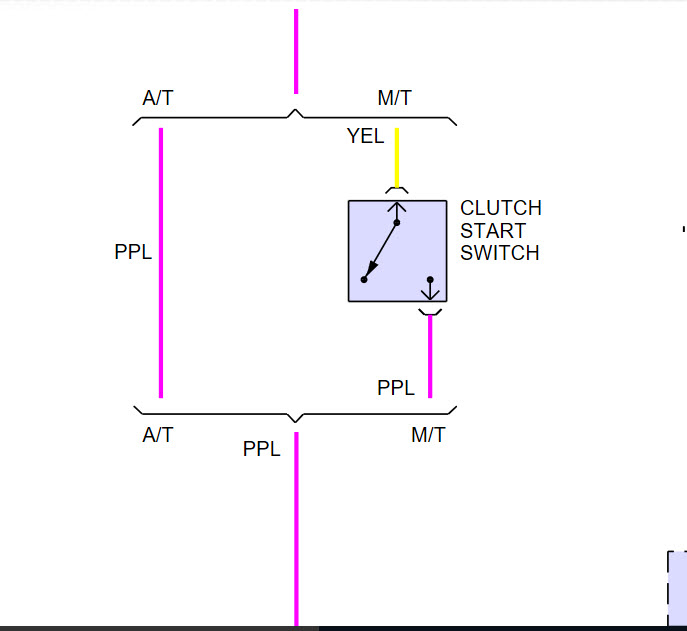

Okay so my truck is the short bed step side single cab. Currently has a 350 in it and had a five speed manual. Swapped it to a th400 transmission and everything went together and plugged in smoothly. Got a 1994 steering automatic steering column and put it in and plugged everything in. Everything works on the truck powers everything but will not start. I hooked up a starter switch and started it off that and it started right up. So I tried jumping the clutch pedal switch and it still will not start I have tested everything and done research and cannot figure it out or how to by pass the metrical safety switch for it to work.
