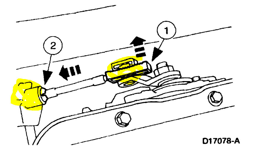

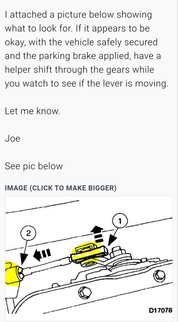

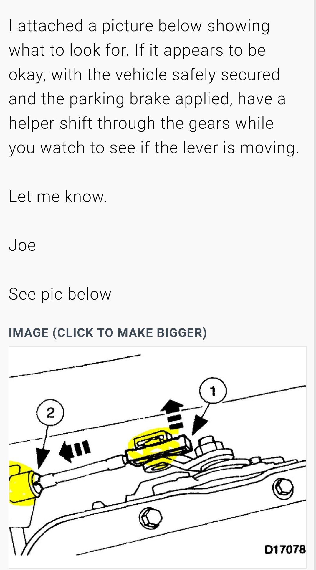

Do me a favor. On the side of the transmission (driver's side) is the shift linkage which attaches to a manual lever on the transmission. Check to see if it is disconnected or if the bracket is damaged.
I attached a picture below showing what to look for. If it appears to be okay, with the vehicle safely secured and the parking brake applied, have a helper shift through the gears while you watch to see if the lever is moving.
See pic below.

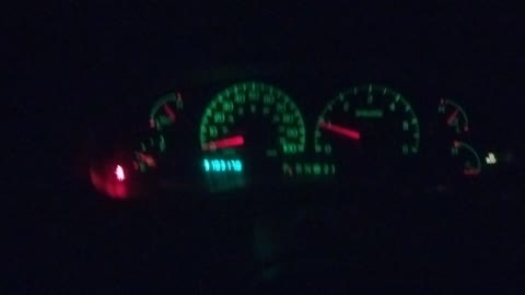

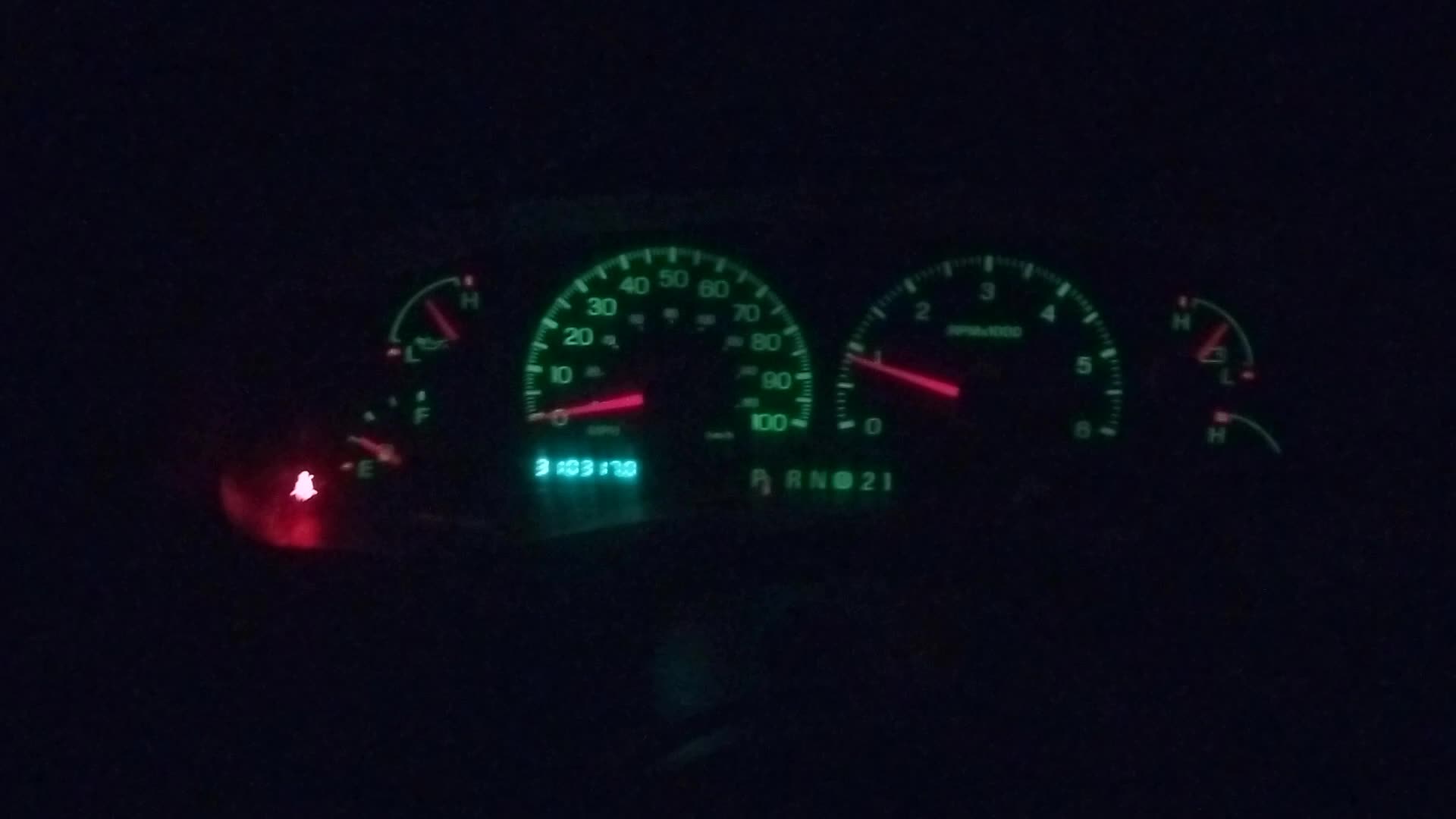

The link is fine. It all started after I let my brother drive it, he brought it back and in the morning, I was going to take the wife to work. I noticed it was in drive and off. So, I put the key to just power and shifted into park and then started it up. What I didn't notice was it was in 4low. I jumped onto the highway did about 50 noticed the switch put back in 4awd and continued. Then it started kind of jerking and then wouldn't respond to the gas pedal. So, I pulled over and did the usual but nothing no drive or reverse. And when I shifted from drive to park it made a weird whining noise and clicking. The engine starts in any gear I think and purs but the speedometer goes up to like 40 and then settles.

I know you're not supposed go that fast in 4low but it was too late when I noticed. The sounds coming from the driver's side kind of under the seat and in the engine bay driver side. I was curious about that, the transfer case shift motor.
Tuesday, October 24th, 2023 AT 7:37 PM
  • 110,192 POSTS
That is my first suspect. Is it possible for you to record the noise and upload it for me to hear?
Tuesday, October 24th, 2023 AT 7:45 PM
VORTEX555
  • 10 POSTS
Yes, it is possible hold on.
Tuesday, October 24th, 2023 AT 7:46 PM
VORTEX555
  • 10 POSTS
Here.

Reply to Joe.
I didn't understand at first but this image you included looks just like that except for it protruded out and doesn't move. I noticed it because everything is full of dirt and grime and it was the only clean shiny thing around.

If you see the shift lever, clean around it to see if something has broken or become detached. Also, make sure the mount that the cable is attached to is also in good condition.
If the lever isn't moving, disconnect the cable and move the lever by hand to see if it goes into gear or park. Please be careful when under the vehicle. Also, rather than placing it in gear, with the engine off and the parking brake on, see if you can get it in park. If you can, then the cable is the issue.
The only thing is that doesn't explain the speedo moving. Regardless, check to see if it is damaged and attached.

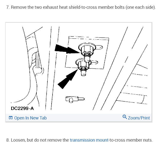

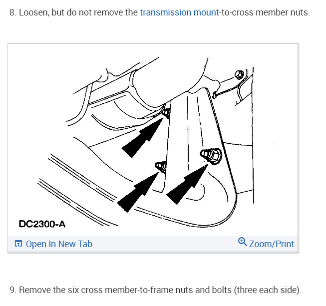

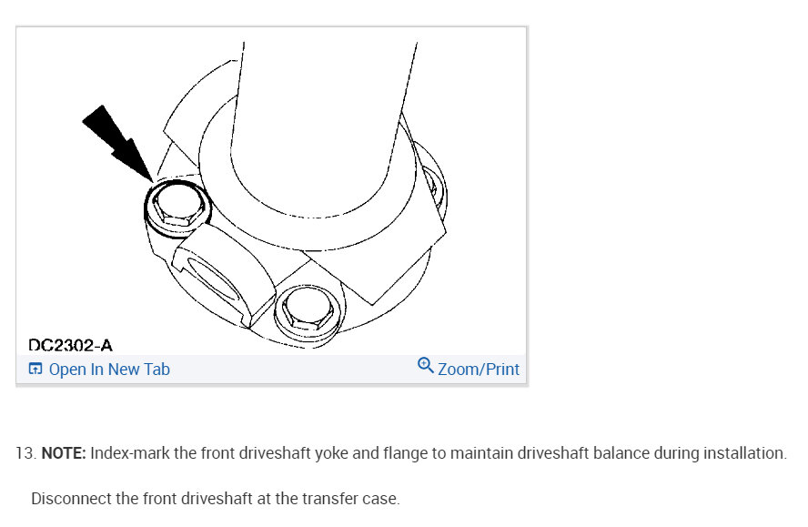

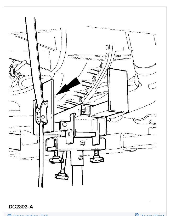

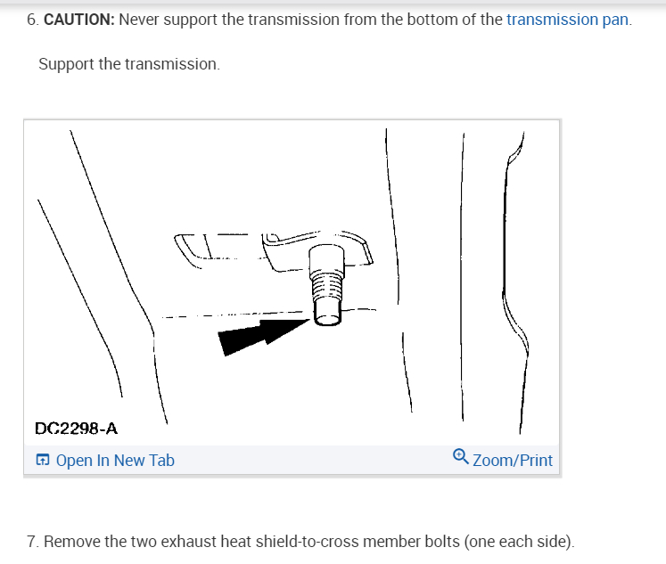

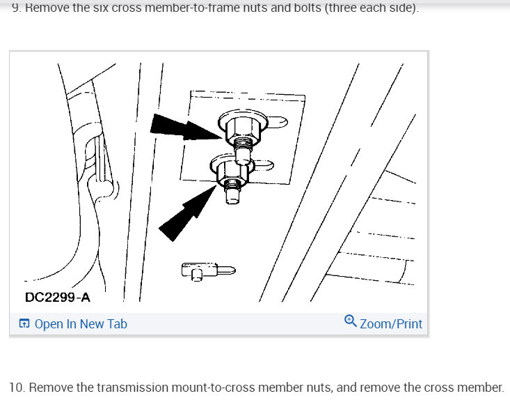

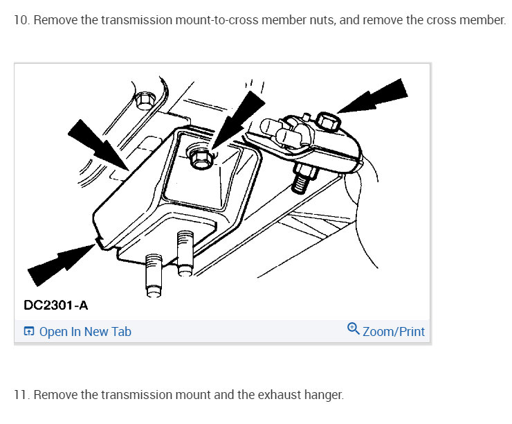

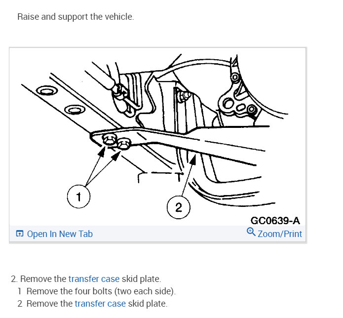

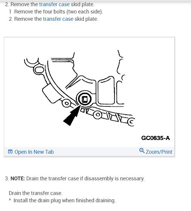

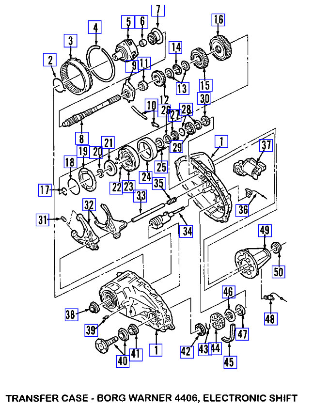

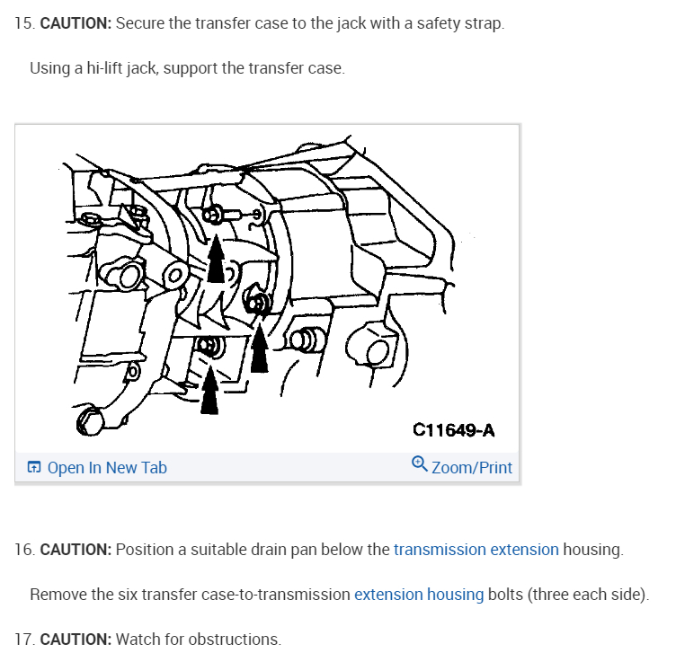

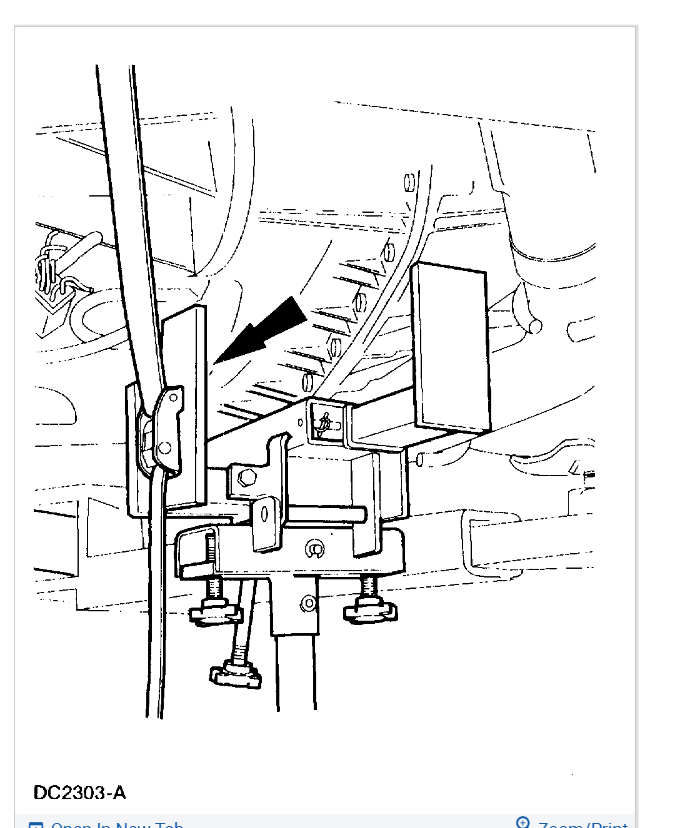

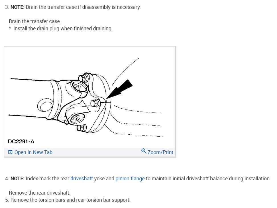

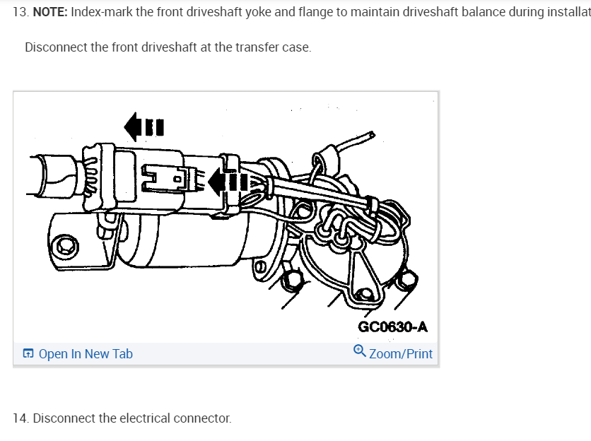

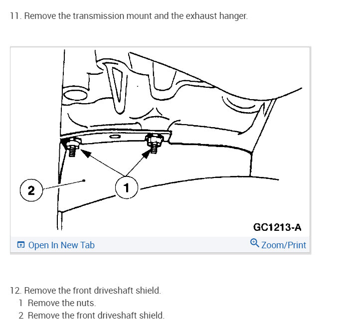

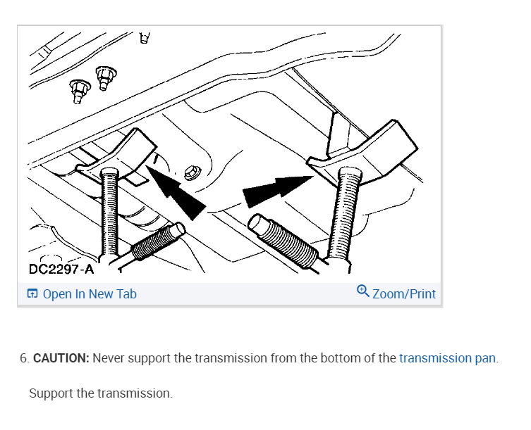

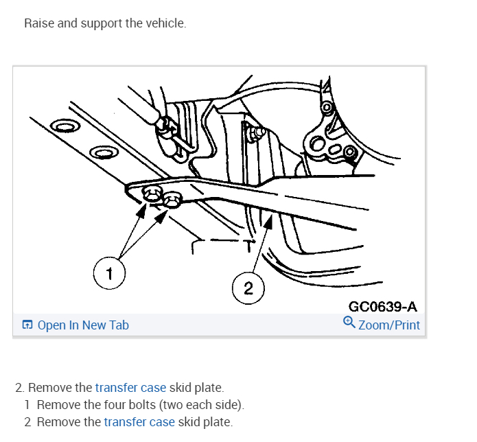

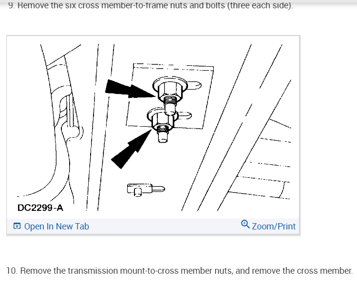

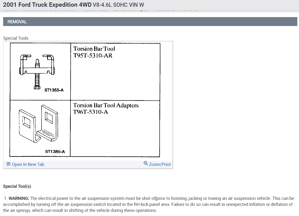

The fact that the speedometer works tells us the output shaft of the transmission is spinning. If the drive shafts are not turning, then something has broken inside the transfer case. I would remove it and disassemble to see what happened, here is how. Check out the images (below). Let us know what happens and please upload pictures or videos of the problem so we can see what's going on.
