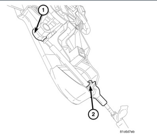

Bought the van listed above at the auction. Was hit on driver's door side.
Was supposed to run and drive.
Was towed to the house.
Goes into drive just fine.
Put into reverse. Will not go into a gear. Engine just revs.
Put into neutral engine revs. Cannot push the Van. So not really in neutral.

I have a few questions. First, is the fluid clean and full? Next, you indicated you can't push the vehicle. It sounds like the linkage isn't working for anything other than drive. Have you checked the shift cable for damage resulting from the accident? The cable is mounted to the side of the transmission to the manual transmission lever. (Pic 1)
Next, when you shift through the gears, does the gear indicator show the correct gear?
See pic below.

Since it is there, I cannot answer your questions thoroughly. Fluid appeared to be clean and full.
I did remove the battery and battery plate so I could see the linkage. Going through the gears it seemed to move the linkage lever just fine.
I believe the lights do light up.
So, I can drive the car. When stopped put it in park just fine.
Put in reverse you do feel and hear slightly something that makes you think it is in reverse. But it's not. Engine just revs. Cannot push the car while in reverse.
Put in neutral. Same thing.

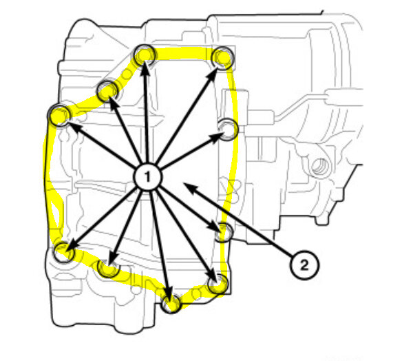

No problem. Since you can't move it even with the engine off and there is a load on the engine when you place it in gear, but it doesn't move, I have a feeling the pinion shaft in the final drive may have come loose and is wedged preventing the vehicle from moving.
If the shop is taking things apart, let me know if that was the issue. You may want to ask their thoughts on that happening. It used to be somewhat common on older vehicles.

It shouldn't require a full overhaul if this is the issue. The first thing I would do is remove the differential cover and inspect the bearings and components. I attached a pic below showing the pan.
Tuesday, November 8th, 2022 AT 6:36 PM
BLOBLOGIC
  • 9 POSTS
Is the differential cover considered the pan?
Wednesday, November 9th, 2022 AT 8:18 AM
  • 110,192 POSTS
No, the pan is what is removed to drain fluid.

I wouldn't recommend moving the vehicle until the cause is determined. To answer your question, if this has a traditional differential (final drive) cover, it is buried behind the transmission and difficult to access. They also used a clamshell design that requires a little more than removing the cover.
It's your call. I will help regardless of your decision.

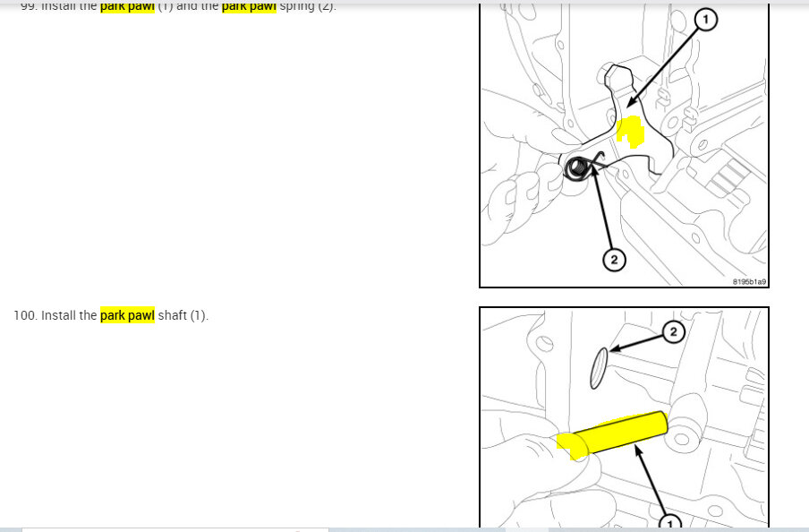

The transmission shop just pulled it.
It was some kind of broke shaft for parking. Tech said, it had to break upon impact of a wreck while in park. So, they are now fixing.
Tuesday, November 22nd, 2022 AT 9:03 AM
  • 110,192 POSTS
A parking pawl. That makes sense. I didn't realize it was in park when it was in the accident. I attached a pic below of the part. It is nothing more than a steel shaft.
When you said the transmission felt like it was placing a load on the engine but not moving, I had a feeling it was something like this. I didn't suspect this part because I assumed it was being driven when it was in the accident. Maybe the vehicle was hit when it was parked.
If you have a chance, let me know how things turn out for you. I'm interested in knowing.
See pic below.
