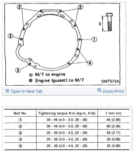

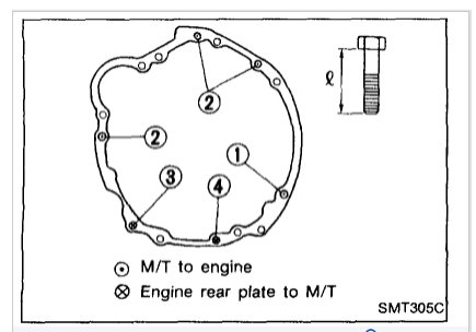

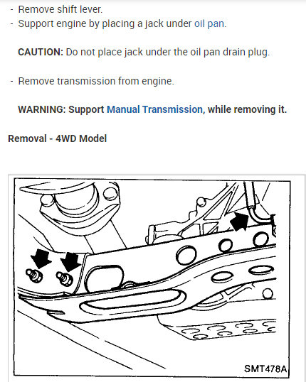

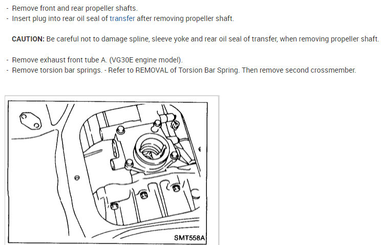

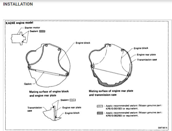

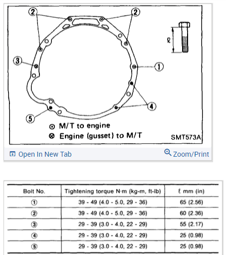

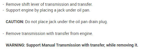

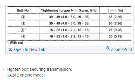

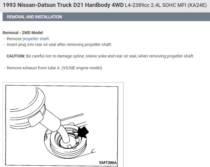

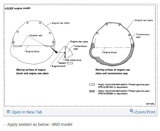

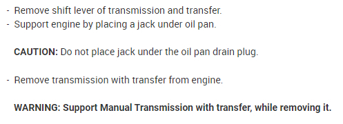

How to remove the transmission?
Sunday, March 24th, 2019 AT 1:03 AM
DANNY L
MECHANIC
5,648 POSTS
Hello, I'm Danny.
Here is the information you requested. Here is a tutorial showing how to remove and replace a manual transmission:
https://www.2carpros.com/articles/transmission-replacement-removal-manual
I've attached picture steps below on how to remove and replace the manual transmission on your Nissan truck. Hope this helps and thanks for using 2CarPros.
