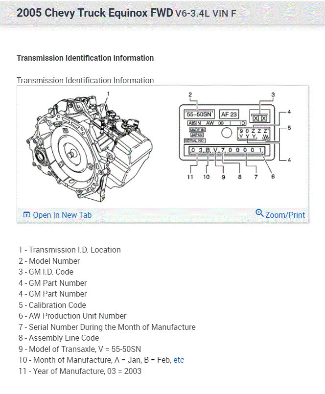

What other transmission can I put in the vehicle listed above?
May 29, 2022 at 8:49 PM
  • 110,193 POSTS
Because of "technology", you can only use the same type. I'm not sure if you have a 4wd model or 2wd model vehicle. If it is a 2wd, the transmission model is a
55-50SN. It was used by different manufacturers, but the problem is they are customized as far as sensors to the vehicle's control module.
If it is 4wd, it has an AF33-5 automatic transaxle. Basically, the same principles apply.

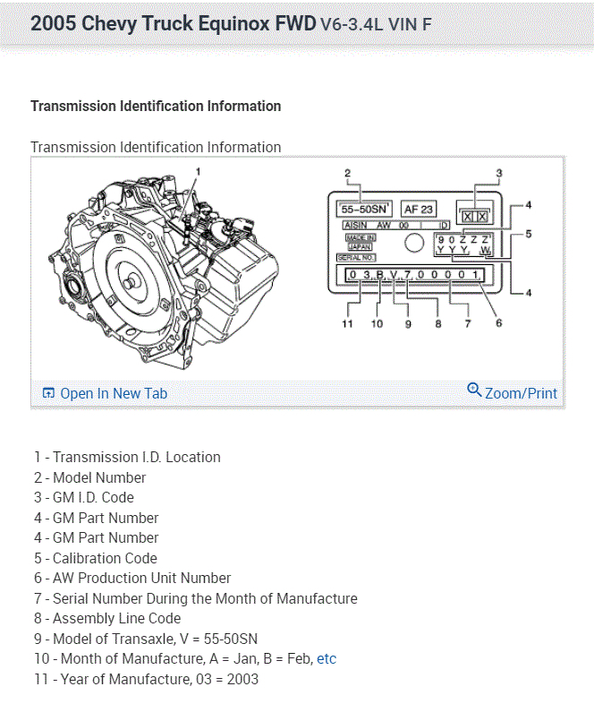

I attached a pic below showing how to identify the transmission type just for confirmation.
Let me know what is happening. Maybe the transmission can be repaired.
See pic below.
