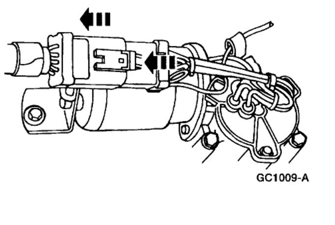

It's in 4 low and I can't get it out it don't say it on the dash but it's in the low side

It sounds like you have a transfer case shift actuator that has gone out. Remove the actuator and see if it responds when the key is on. Here is a diagram of where it is.
