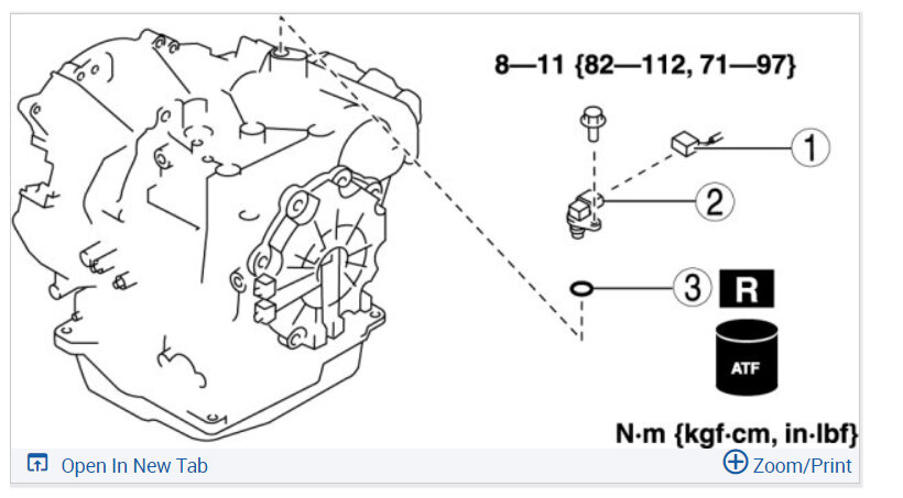

It does sound like the turbine or intermediate shaft sensor might be bad, but we should run the codes to see which ones are stored, even though the light is off there can be codes still.

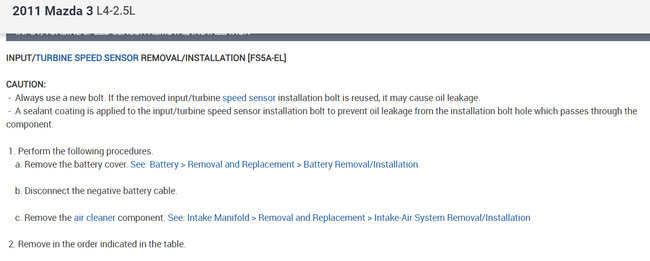

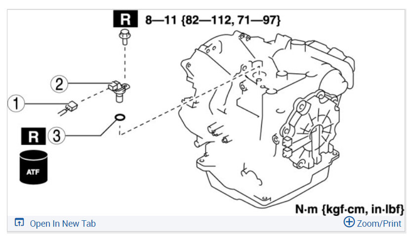

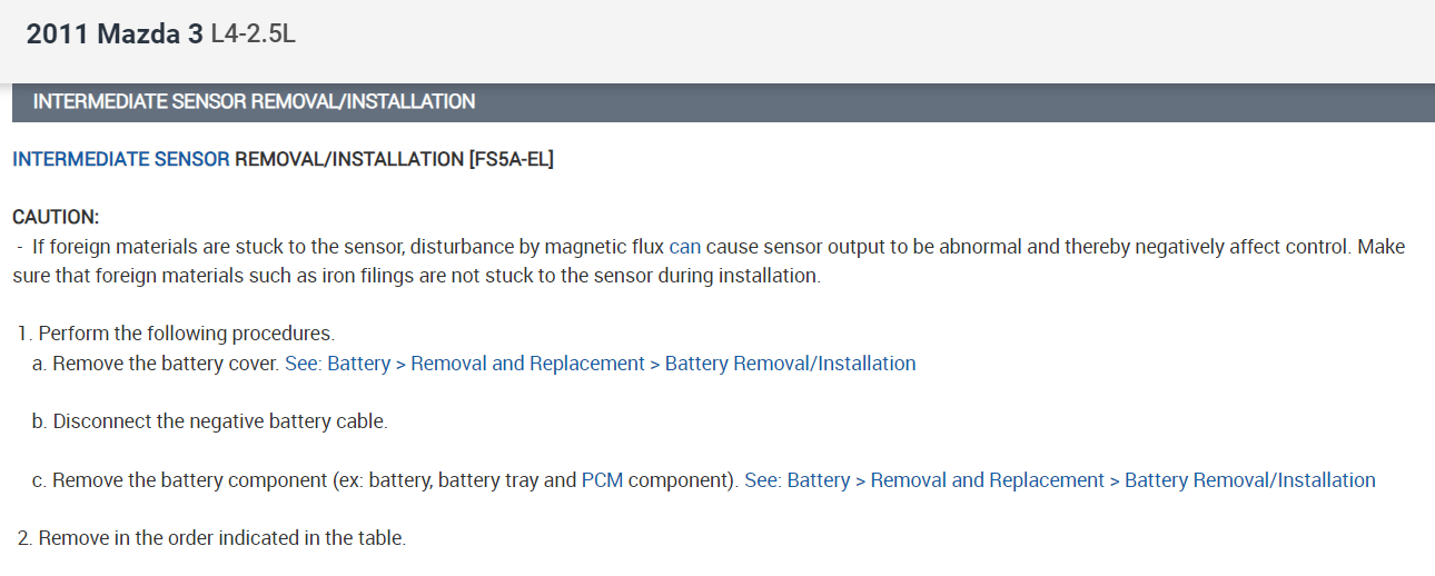

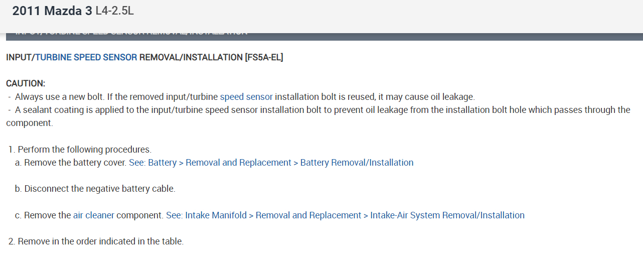

Here is the location of the turbine and intermediate speed sensor so you can check the electrical connector for corrosion and if a code is present for it swap it out. The sensor can be weak and cause an issue as well. Check out the images (below). Please upload pictures or videos in your response of any problems so we can see what to help you with.
