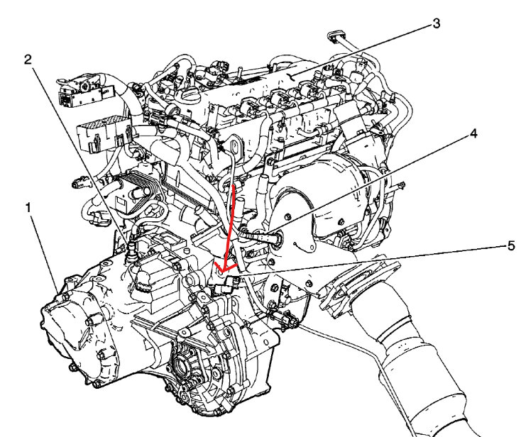

My car starts and idles fine. It goes in reverse and drive. When in drive and go to accelerate it doesn't shift gears and my speedometer stopped working
Aug 27, 2025 at 8:15 AM
  • 54,494 POSTS
This happens when the VSS goes out, here is the location so you can swap it out and fix the problem. I marked the image below to help you find it. Check out the images (below). Let us know if you need anything else.

When I accelerate to maybe 10-15mph my RPM gauge increases to 3000 plus rpms
Aug 27, 2025 at 8:29 AM
  • 54,494 POSTS
Yes, it sounds like it is not shifting did you change the sensor out?

Late delivery for the new VSS. Just got done installing the new one. I'll test it tomorrow to see if it fixed it.
Aug 30, 2025 at 6:21 PM
  • 54,494 POSTS
Good job :)
Aug 30, 2025 at 7:08 PM
JOSHUA Q REYNOLDS
  • 13 POSTS
Still no speedometer and not shifting.

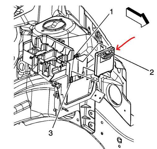

Crap! I love an easy fix that doesn't work, what the heck! Okay, now we get to start looking deeper, so the input for the vehicle speed goes through the TCM and then onto the PCM so we might have an issue with one of them, if I had to guess I would say the TCM is the issue, to be sure lets run a CAN scan. Here is a video to show you how. You might want to check the ECM/TCM fuse (#25) on the BCM which is inside the car under the radio, and the ECM trans fuse (#43) in the fuse panel under the hood, if the fuses are good disconnect the battery and remove the electrical connector form the TCM to check for corrosion. Here is its location. If all else fails let try doing a CAN scan which should give us a code that we can work with. Here is how
https://youtu.be/u-4syLc-ifQ
Check out the images (below). Let us know how it goes
