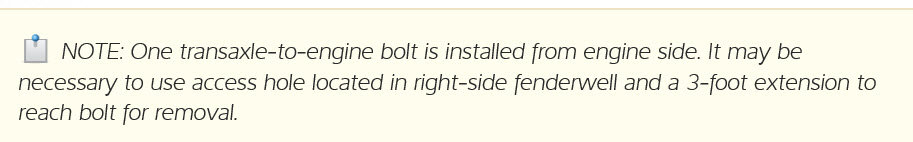

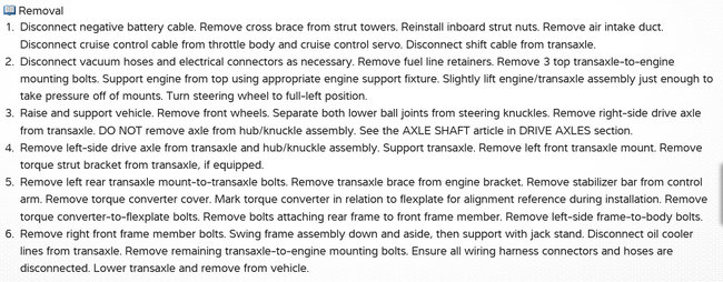

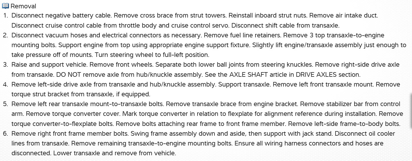

When taking out a transmission in a 97 Buick do u have to take off both transaxeul and hub on both sides or just take everything off where the transaxeul is running into the transmission
Monday, January 4th, 2016 AT 10:28 AM
HMAC300
  • 48,601 POSTS
You don't need to take the hub off just disconnect from cross member and swing out of the way see pics for instructions. Will send in another email
Monday, January 4th, 2016 AT 11:59 AM
HMAC300
  • 48,601 POSTS
See pics
Monday, January 4th, 2016 AT 12:00 PM
