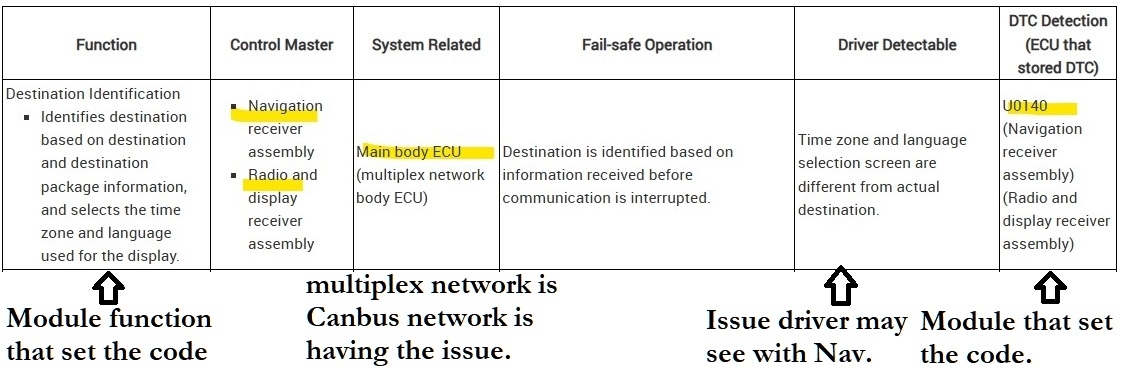

Hello, just looking through the code information, the U0140 is listed as (U0140 Navigation receiver assembly)(Radio and display receiver assembly), So this looks more like a communication issue with the Can bus network, if there's an issue with the network itself and its shorting to ground or power, whatever may be happening can definitely cause issues with other modules on the network,
I'll post what's in service info about the code, but it looks like either the Nav system or Radio is having trouble communicating to the Main Body ECU. I'd expect more network codes in other modules if they were having issues as well,

This is the info on that specific code. Have any other DTCs set in any other modules?
