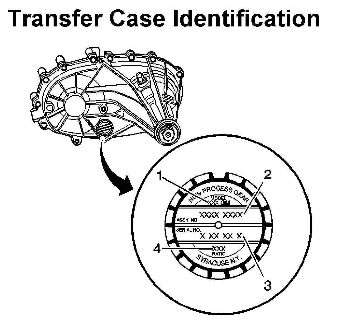

I have got a 246 transfer and i am trying to figure out what the 1258 0184 on the tag is.

The information below explains what all the numbers are for on the identification tag. Pic 1 correlates with this info. The number you are referring to is called an assembly number or a broadcast code. It is used during assembly to make sure the correct component is used during assembly.
___________________
2003 Chevy Truck K 1500 Truck 4WD V8-5.3L VIN T
Transfer Case Identification
Vehicle Application and ID Components Transfer Case Identification
TRANSFER CASE IDENTIFICATION
An identification tag is attached to the rear half of the transfer case. The tag provides the following information:
1. Model number (1)
1.1. First Digit-1 =Single Speed, 2=Two Speed
1.2. Second Digit-2 = T- Utility, 3 =T-Truck, L-Van, 4 or 6 = K Truck and Utility
1.3. Third Digit-1 = Manual, 3 = Electric Shift, 6 = Automatic, 9 = All Wheel Drive
2. Assembly number (2)
3. Serial number (Date & Shift Code) (3)
4. Low range reduction ratio (4)
The information on this tag is necessary for servicing the transfer case. If the tag is removed or becomes dislodged during service operations, keep the identification tag with the unit.

A guy is wanting to buy my transfer and we was comparing the tags and wanting to know if they are the same mine is 1258 0184 and his is 1258 5239 but they are both 246 GM transfers.

Compare all connections. The assembly number shouldn't change the basic design, but it will be based on what type of vehicle you took it from and what it's going into.
Also, there could a gear ratio difference.
