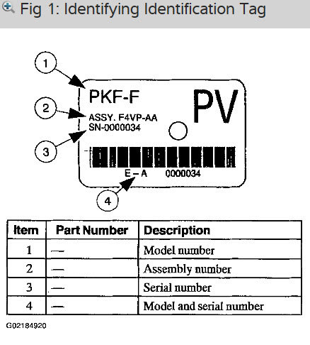

Can I put a Harley Davidson F-150 transmission in my truck listed above it is the XLT model?

As long as it is a 4x4 transmission and ID tags match up on transmissions forgot to put ID tag example in get in another email.

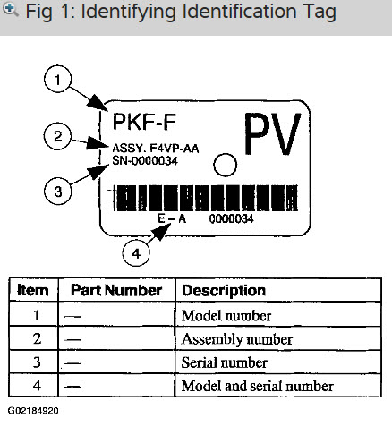

See picture.

We do not list a lot of models so as long as id tags are the same and it is a 4x4 transmission as it will not have an extension housing on it and shaft will be short it will fit just like I said previously. The Harley Davidson designation is mostly the way the truck is like badges etc. Drive-train is the same as a regular truck.

4x4 transmissions are different from two wheel drive the 4x4 normally has a shorter output shaft so it will go into the transfer case. A two wheel drive has a longer output shaft with an extension housing and will not work on a 4x4 application. Id tags can be the same but different application. Check the transmission you currently have in the truck and see if it has an extension housing that looks like the one outside the truck. If not it will not work.
