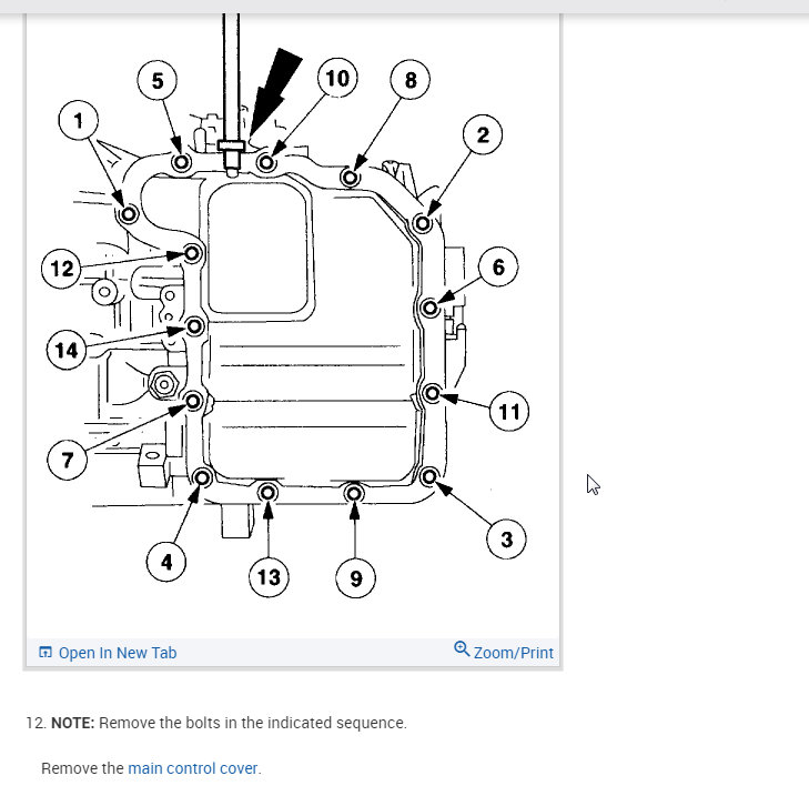

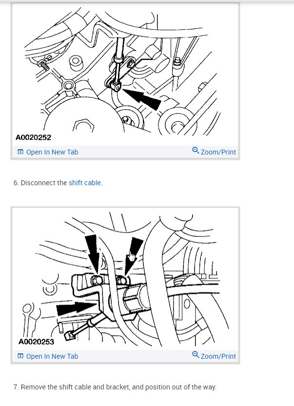

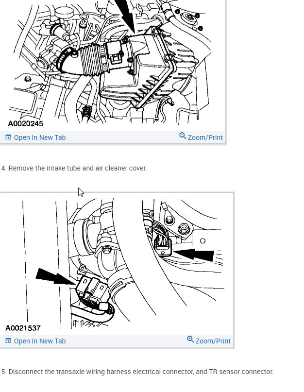

transmission shift solenoid replacement
2001 FORD ESCAPE
200 MILES • 3.0L • V6 • 4WD • AUTOMATIC
BYRONSESSOMS

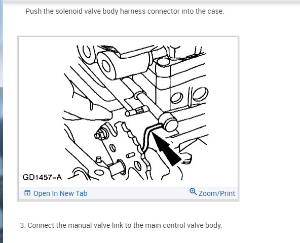

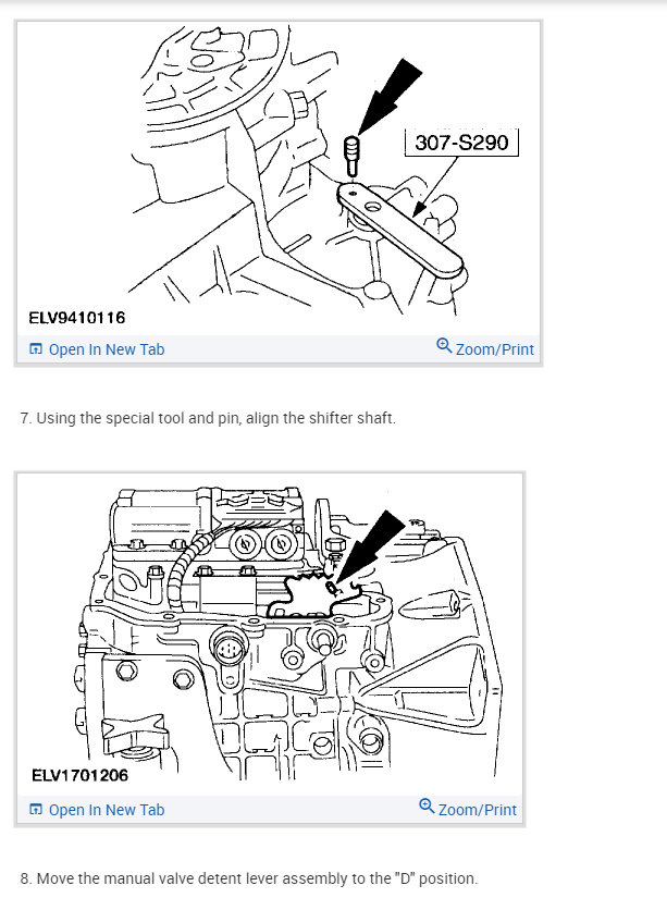

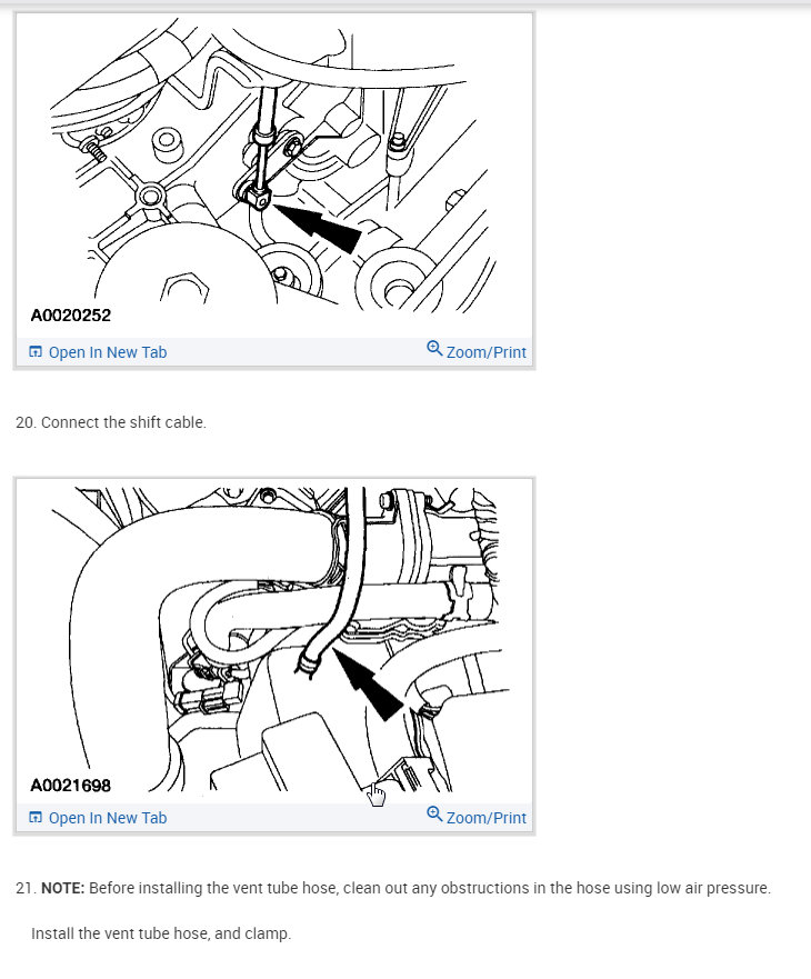

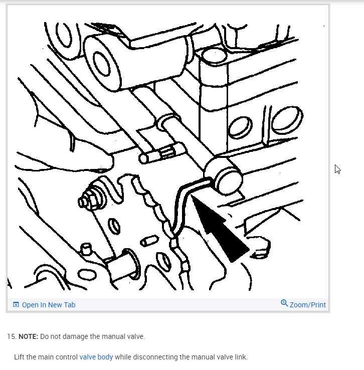

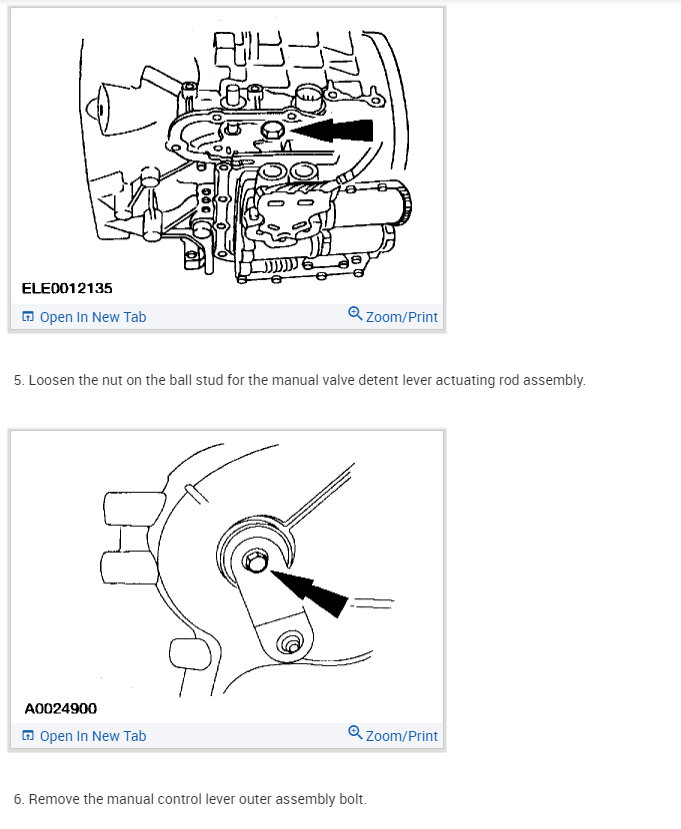

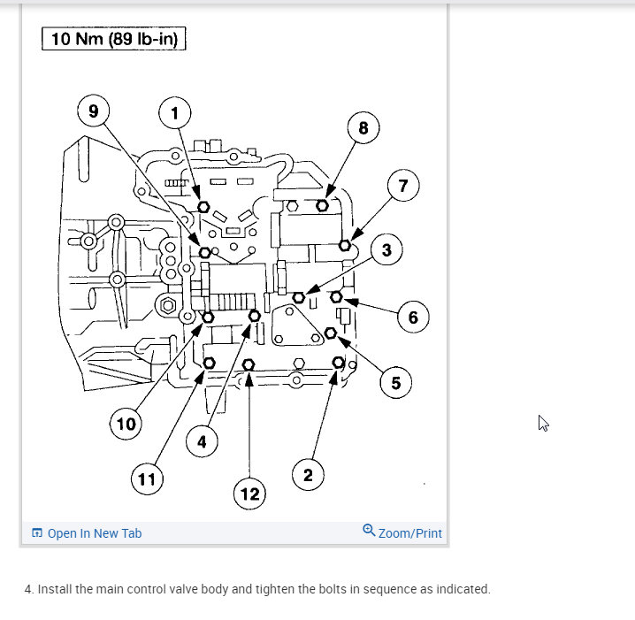

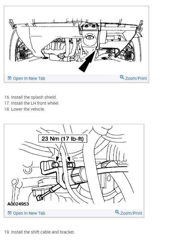

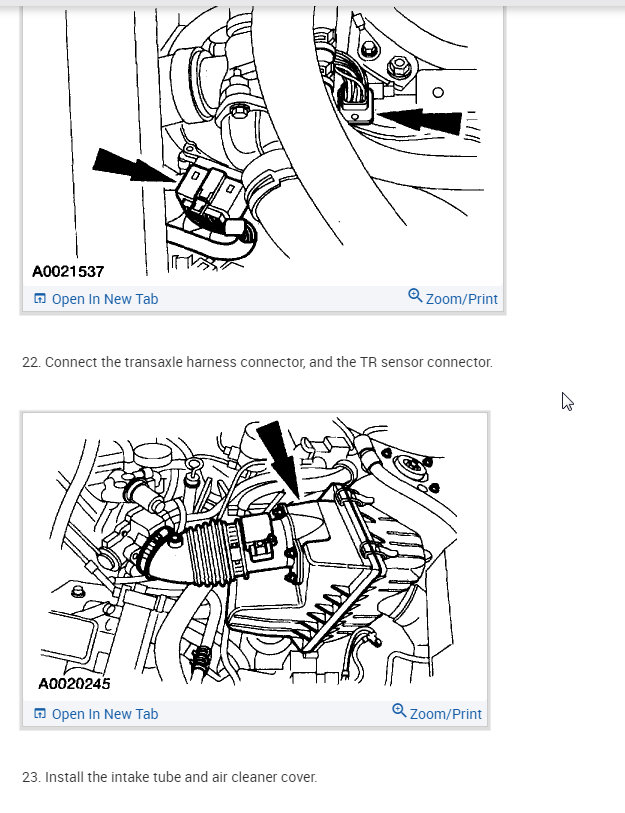

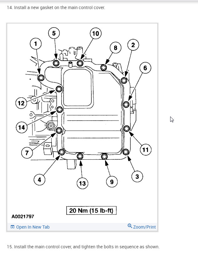

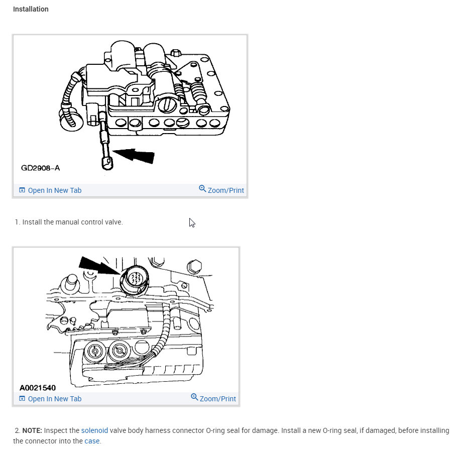

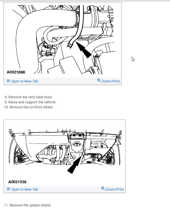

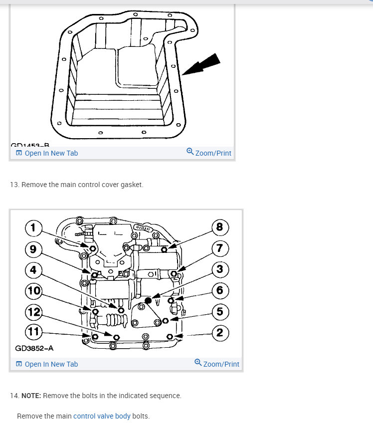

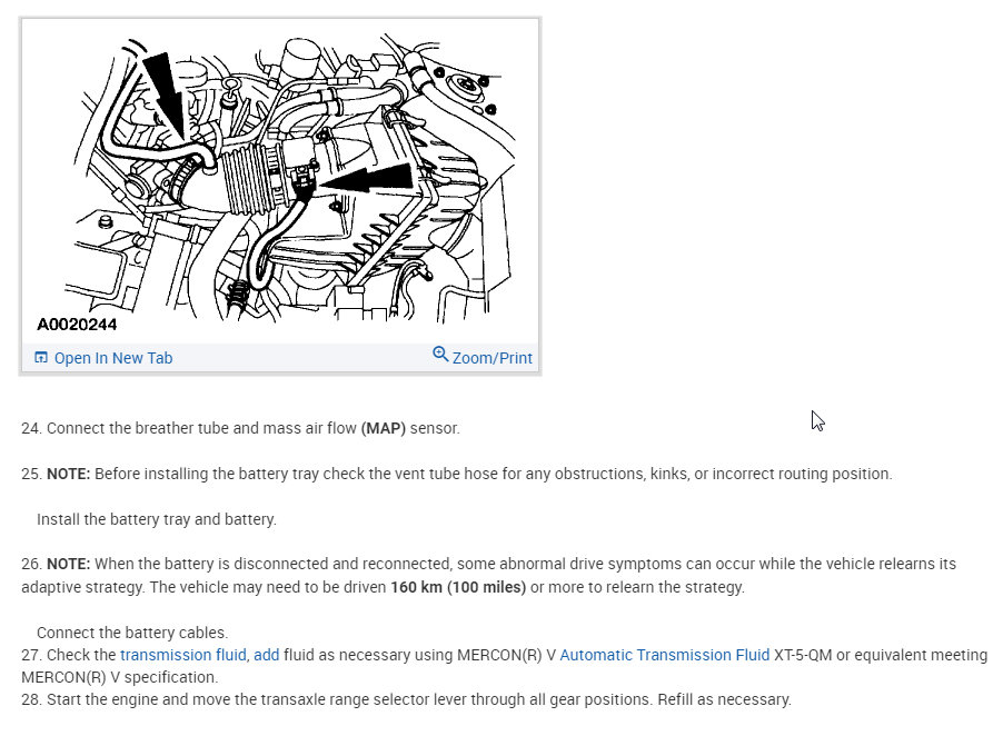

can they be replaced without removing the transmission?
Jun 22, 2019 at 7:12 AM
  • CAR REPAIR CONTRIBUTOR
Hi Byron,

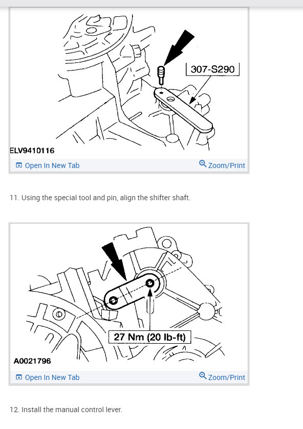

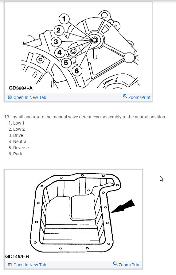

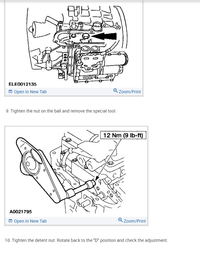

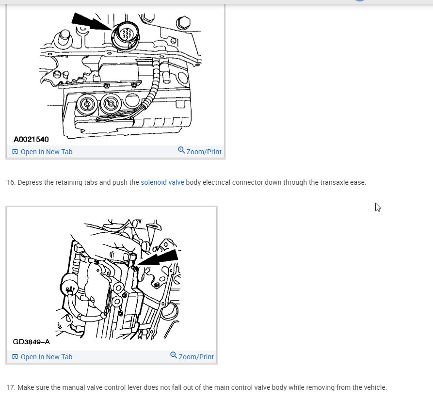

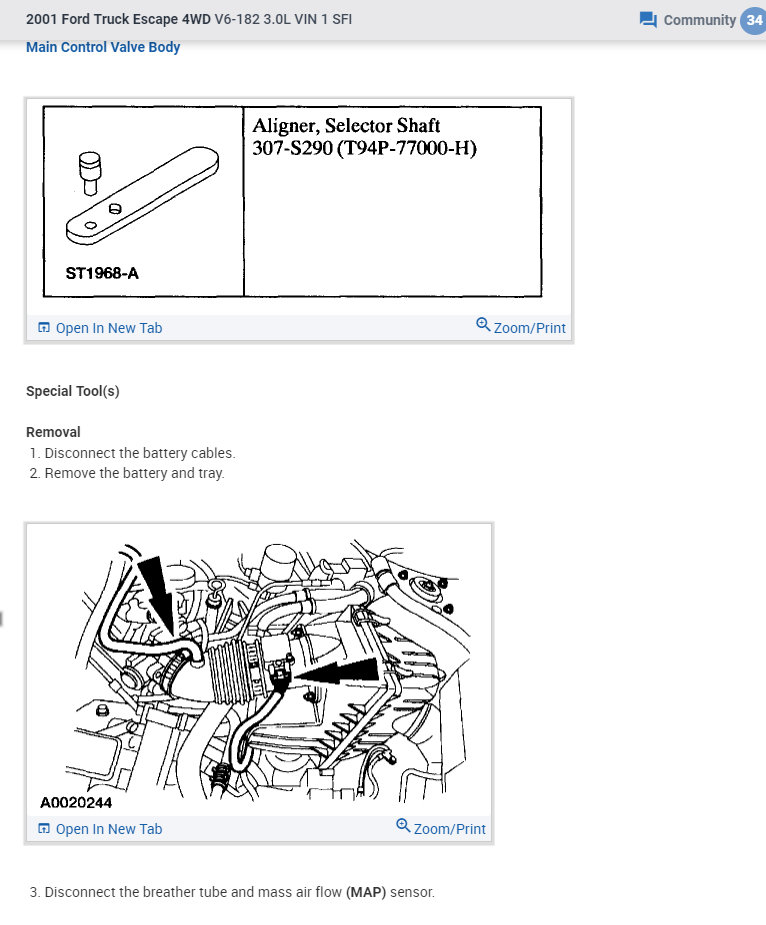

I assume you are talking about the shift solenoids that are in the valvebody? If so, I included the procedure on how to remove the valvebody and reinstall it and yes, you can do it without removing the transmission.
Please let me know if you have any other questions on this issue. Thanks
Jun 22, 2019 at 10:14 AM
