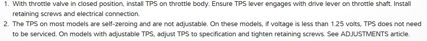

do i need to adjust the new TPS screws on my car or just install the new TPS? i read that some need to be adjusted.
Mar 8, 2017 at 8:24 AM
HMAC300
  • CAR REPAIR CONTRIBUTOR
  • 48,601 POSTS
I think it is a straight shot of disconnecting electrical and undoing screws. i am sending instructions while you are doing this clean throttle plate on both sides and IAC hole with choke cleaner.
Mar 8, 2017 at 9:37 AM
CHYANNE SHERIFF
  • 85 POSTS
Thank you HMAC300 for your help. The throttle and iac were cleaned and the tps installed .. she has more power and running great!
