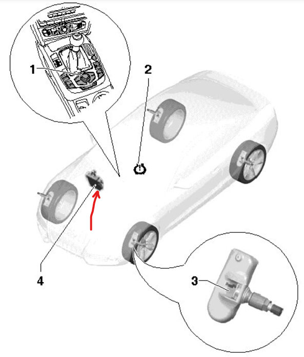

Need TPMS module location for 2012 Audi Q5

the tpms modual is located in the right front area foot well under /behind the glove box and under the carpet and insulator has 2 nuts holding it in place ... that said.. I'm assuming its already been checked and tested with a tpms tool at the wheel sensors they're a common place to look first they're life expectancy is only about 5 years so they usually go first ? good luck hope this helps

Here is the location for clarification. Check out the images (below). Let us know how it goes
