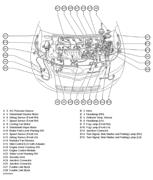

MMPRINCE4000
  • 8,549 POSTS
There is an ambient temp sensor:
-1
Sunday, November 21st, 2010 AT 1:45 PM
