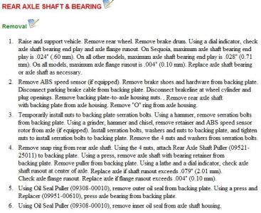

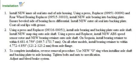

Need some info about replacing rear wheel bearings
Monday, January 25th, 2010 AT 10:36 AM
BLUELIGHTNIN6
MECHANIC
16,542 POSTS
Thursday, April 22nd, 2010 AT 9:50 PM
