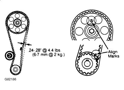

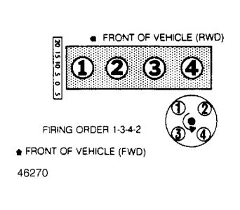

I changed the cylinder head gasket and all other gaskets of parts removed once I put everything back together I thing the timing is off because it won't turn on everything seemed to be lined up I have a Manufactures mechanical biik and followed instruction just as stated but it just wont turn on. So How to I align the Camshaft, Crankshaft, and Distributor so it may start once more? Like reseting once again. The manufacture doesnt explain anything in the manual

Have you checked the compression in each cylinder? if its low then you know its not in time..
https://www.2carpros.com/forum/automotive_pictures/261618_Graphic_370.jpg
https://www.2carpros.com/forum/automotive_pictures/261618_Graphic2_53.jpg
