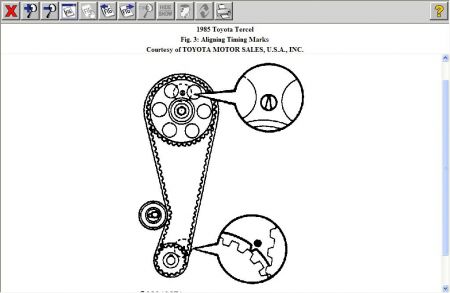

Not sure how to change the belt the easiest way possible.

Put the engine's no.1 piston on its compression/TDC then line camshaft and crankshaft sprockets as shown below then slap on the belt and front cover and retime the engine.
https://www.2carpros.com/forum/automotive_pictures/12900_tb_1.jpg
