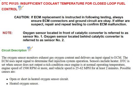

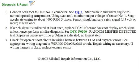

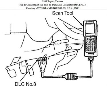

I believe you have got the wrong sensor. The code is for the Heated O2 sensor. Here are the diagnostic procedures.

Thank you for the replies. I have tried to measure the voltage of the oxygen sensor like you suggested but I am not familiar with this function on the scanner.
I'm using the Actron Autoscanner plus model CP9180. I found an option under vehicle diagnostics that shows the RPM of the vehicle along with temperature etc. There is one line that says O2S1 v- I am guessing that's the one that monitors the voltage of the O2 sensor #1...? I snapped the throttle up to 4K RPM's 3 times and the O2 sensor #2 went up to the 0.800-0.900 range while the O2S1 hardly changed at all.
I think we're very close to solving the problem (thanks to your help) but there are 2 oxygen sensors and they are $125 each. I really need to know for sure before I purchase one of the sensors.

If the reading of the # 1 sensor is hardly moving, then it should be faulty as it is the upstream sensor, the one before the catalytic converter. You reading are opposite of what Merlin pointed out, as if the sensor circuits had been reversely installed.
Reconfirm the readings.
Jul 1, 2009 at 7:03 AM
CHADLEY22
The sensor before the catyltic converter reads about 0.005- almost no fluctuation, goes up to 0.015 at high RPM...while the one after the cat reads anywhere from 0.025 to 0.975
I tried changing it but the nuts were so rusty they crumbled in my hands. Got to have new threaded studs welded on and hopefully get the O2 sensor replaced tomorrow.
Jul 1, 2009 at 8:14 PM
KHLOW2008
  • CAR REPAIR CONTRIBUTOR
  • 41,814 POSTS
Yes, that seems to indicate the front sensor is bad.
