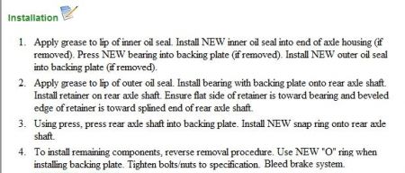

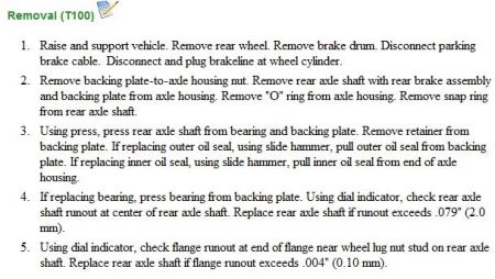

I need information on procedure for removing this axle, I mainly don't know if there is a keeper ring on the axle inside the differential. Thanks

THANKS SO MUCH, YOU ANSWERED ALL MY QUESTIONS ABOUT THIS TASK AND YOUR GUIDANCE WILL MAKE EASY TO CHANGE THIS AXLE. GOOD JOB! LARRY
