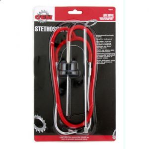

https://www.2carpros.com/forum/automotive_pictures/46384_stethoscop_1.jpg
this a mechanic stethoscop. it cost $9.90 at autozone.
Place this stethoscop on the valve cover.
tell me your found.
remove all the spark plugs, squir litle heavy oil in each spark plug hole , then put the spark plugs back
start the engine.
tell me your found.
we are checking the pistons rings and the valve guides.
