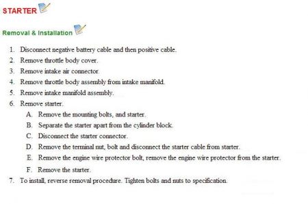

Were is starter located on 4.7L V8 2003?
How difficult is it to change?

Just follow positive battery cable through engine compartment if you have difficulties locating starter..
