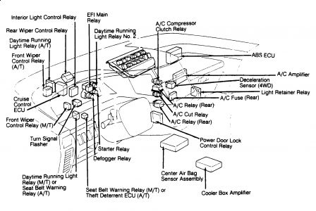

Help, We cannot find the flasher relay. Where did they hide it?
Wednesday, September 2nd, 2009 AT 5:52 PM
BLUELIGHTNIN6
MECHANIC
16,542 POSTS
You will need to remove the lower panel under the steering wheel to get the relay.
