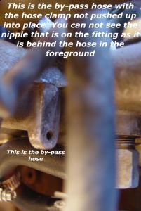

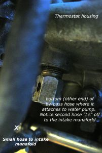

https://www.2carpros.com/forum/automotive_pictures/455946_location_of_parts_1.jpg
I may not have been clear as to the location of this fitting. It is under and attached to the thermostat housing. It has a hose attached to it, so it cannot be turned/tightened. If a bleeder valve is in this location it may have came out of the hole that is now leaking. The hose attached I believe is a bleeder hose and the other end attaches to the water pump. At the other end there is another "t" with a hose that seems to go to the intake manifold.

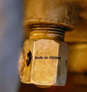

https://www.2carpros.com/forum/automotive_pictures/455946_view_of_hole_1.jpg

The part that I am seeing doesn't have a hose attached to it. It looks like a bleeder for air to escape when servicing the cooling system. It has a small round hole in it. Also, most (if not all) bleeders are attached to the thermostat housing.
Maybe I'm confused. If the part that I'm looking at is what you are having trouble with, I don't see a hose attached to it. It looks (aprox) like a 10mm socket would go right on it. Please let me know if I'm not looking at the right part. If I was there with you, you could tell me in less than 2 seconds, but the internet makes it a little harder.

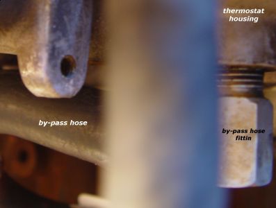

https://www.2carpros.com/forum/automotive_pictures/455946_hose_1.jpg
https://www.2carpros.com/forum/automotive_pictures/455946_description_and_view_of_bypass_hose_1.jpg
Yes it is difficult to explain. especially since I can not see it. I stick my camera under the manifold and shoot blind. I am not even sure what I am shooting, but believe this fitting is screwed into the thermostat housing. It has a nipple on the side with this hole adjacent to it. I marked the location of the hose in one photo ---you can see just a little of the nipple protruding on the left of the fitting. The connection is behind the hose that is blocking the view (in the foreground). I can not turn this fitting without removing the bypass hose. We replaced this hose thinking it was where the leak was only to find the hole near by. If this is the location of the bleeder was the bleeder valve in this hole?...Thanks again for all your patience and help,
Vickiie
Monday, January 4th, 2010 AT 3:00 PM
  • 110,194 POSTS
Actually, the pictures are perfect. Great job for not being able to see what you are taking pictures of.
Now I have a new concern. It looks like it is screwed into a manifold and not the t-stat housing. All I can say at this point is to remove it and replace it with a new one. It still looks like a bleeder to me, but I can't be 100% sure. I tried looking everywhere in my manual and can't find a picture of it. I even checked out every different thermostat housings made by them and nothing. I checked out online manuals and nothing. Based on what I see, I say it is a bleeder and the hole is to be there. God I wish I was there. It would be so much easier. Also, based on your last picture, it looks to be bolted into the intake manifold. I am going to send the picture to the boss here and see what he says.

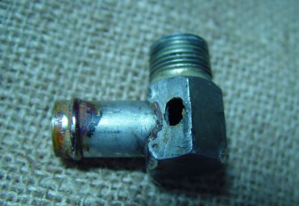

Hey thanks for all the help. I took the pics to our Toyota dealer and they found the part. It is an elbow. The hole is not supossed to be there. It is interesting though, I bought the truck used in 1994 and it has always used water/anti-freeze. I never could find where it was going it just didappeared, there was never a puddle under the truck. I m thinking this must be where I have been losing i The hole has just worn into the metal over time and what is weird is there is another hole identical to it worn through on the other side. There is staill a paper thin piece of metal left over the hole so at this point coolant was leaking out both holes. I got a picture of the elbow out I tried getting a picture of the "new hole" but it did not come out.
Thanks again for your help!
Vickie
https://www.2carpros.com/forum/automotive_pictures/455946_toy_part1_1.jpg
