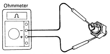

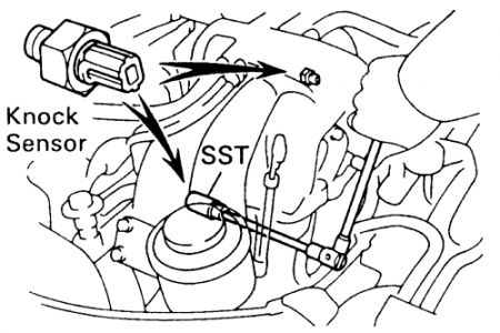

I cannot find the knock sensor, I have a manual from Haynes and it gives no test procedure or location. I read the codes and knock sensor has came up. Does anyone know how to find it or test it?

Passenger side, upper engine area, below center of intake manifold, mounted in block.
To Test:
1. Remove knock sensor
2. Using an ohmmeter, check that there is no continuity between the terminal and the body. If there is continuity replace the sensor.
Location of knock sensor
https://www.2carpros.com/forum/automotive_pictures/103836_toy2_2.jpg
To test knock sensor
https://www.2carpros.com/forum/automotive_pictures/103836_toy1_2.jpg
Knock Sensor
https://www.2carpros.com/forum/automotive_pictures/103836_knock_1.jpg

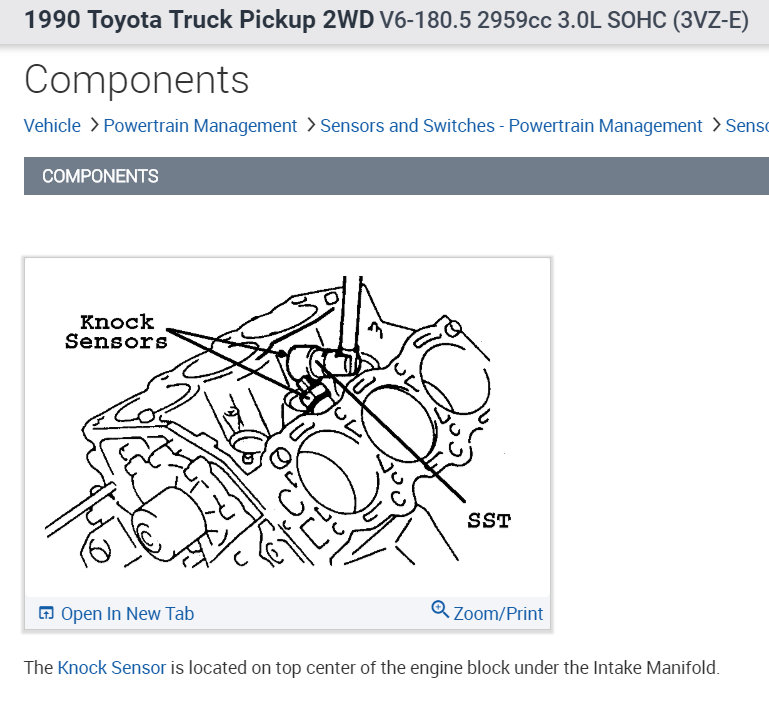

Where is my knock sensor located on my 1990 toyota SR5 pickup. I need to replace my knock sensor is it hard top do it wont pass inspection check light comes on. First the code 032 came up for the mass airflow sensor. I replaced that now the check light still comes on and its reading 052 for the knock sensor.
+4
Monday, October 8th, 2018 AT 12:59 PM (Merged)
DOCFIXIT
  • 18,828 POSTS
The knock sensor is located under the intake manifold on the engine block. Check out the diagrams (Below). Please let us know if you need anything else to get the problem fixed.
