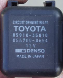

Hi, back after the holiday break and a bout of shingles. Yes, the clicking module is the COR as shown.

DOCFIXIT
  • 18,828 POSTS

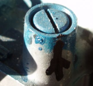

Then TPS is at fault go to throttle find screw give it a slight turn 1/8. If clicking stops good if not need to replace TPS

  • 8 POSTS
Well the 1/8 turn did stop the COR from clicking,
as well as preventing the engine from cutting out.
So now that makes me wonder. The TPS screw had been set in place back in August at a certain point, after I'd had some major work done (new timing chain, valves, airflow sensor) at a shop. So there must have been some sort of "settling" of the system over time? I first noticed the COR clicking occuring sporadically in like October, then it became more frequent after the engine would warm up after use.

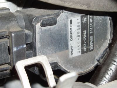

93TYPKUP
  • 8 POSTS
So might as well replace it sooner than later?
https://www.2carpros.com/forum/automotive_pictures/286195_TPS_adjusted_172009_1.jpg
https://www.2carpros.com/forum/automotive_pictures/286195_TPS_toyota_truck_1.jpg

DOCFIXIT
  • 18,828 POSTS
Yes a new one might be best. There is a proceedure to set up. If not in instructions with TPS let me know and will provide. Need OHM meter

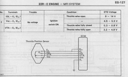

Hmmm. Maybe the TPS is further gone than thought. I tried measuring for ANY voltages according to the Toyota manual (shown below), with the ignition switch on, and am not reading any voltage across any of the terminals. ?

DOCFIXIT
  • 18,828 POSTS
Pull term measure from E2 to ground what do you get? Throttle fully open ohm from VTA to E2 3300 to 10000 ohms
