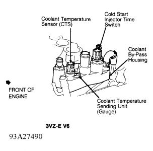

Engine Cooling problem
1992 Toyota Pickup 6 cyl Four Wheel Drive Automatic
Can you tell me where the Temperature Control Sensor is located on my year of a truck?
May 13, 2010 at 11:50 AM
  • CAR REPAIR CONTRIBUTOR
  • 75,992 POSTS
If you are referring this sensor as part of the AC the only one that comes close is the AC Evaporator Temperature Sensor which is located on top of the evaporator inside housing. Now if were talking coolant temperature The coolant temperature sensor and the coolant temperature sending unit are located on the coolant bypass housing at rear of intake manifold-See below
