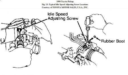

1992 Toyota Pickup 4 cyl Two Wheel Drive Manual
my truck turns off when I reach my destination, bieng 10 miles or 30 miles. But it will turn back on quickly it also shakes when I come to a stop then turns off

Seems you have an idling issue and I would suggest adjusting the idle speed.
http://www.2carpros.com/forum/automotive_pictures/192750_IdleScrew90Pickup_2.jpg
Turning the screw anti-clockwise would increase the dling speed.
Is the Check Engine Light showing?

Well I adjusted the idle so how can I get a hold of you agian well you reply to me tommorow cause I still have to test drive it home and I will find out if that did the job or do I have to pay for the sevice agian. Thanks george

Well thank you againI am pleased to used your services. The truck is working fine now, I had no trouble today or yesterday getting to work and home.I will return to use these services again. Again thank you very much. George valdez
