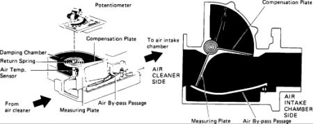

my 90 toyota pickup will sometimes start & run just fine. Other times it won`t start right away if I click the starter about 20 times it will start. This has nothing to do with the starter or battery it cranks over good.I jumped the diagnostic fuel pump terminals like you said & the truck runs just fine. How long can I run this truck in that mode till I can repair it & do have any ideas whats causing this problem maybe a relay or wiring.

Remove the jumper from the DLC and block wide open the airflow meter vane flap and see what happens-let me know.
As long as you want -mine was a defective airflow meter and the jumper is still in place its almost 3 yrs now-
Could also be the circuit opening relay-the airflow meter has to ground the Fc terminal of the COR to power the fuel pump

Description and Operation
Air Flow Meter
https://www.2carpros.com/forum/automotive_pictures/12900_maf_5.jpg
A Bosch vane type airflow meter is mounted in the air induction system near the air cleaner. The airflow meter measures intake air volume, and converts these readings into voltage signals by means of a variable resistor (potentiometer). These voltage signals are then sent to the ECU and used to determine injection duration and proper fuel delivery. When intake air volume is low, the voltage is high; when the intake air volume is high, the voltage signal is approximately zero.

You don't have to worry about bypassing the airflow meter all it does for the fuel pump is to ground the circuit opening relay to power the fuel pump-you can keep your jumper in the diagnostic link connnetor hooked-up
