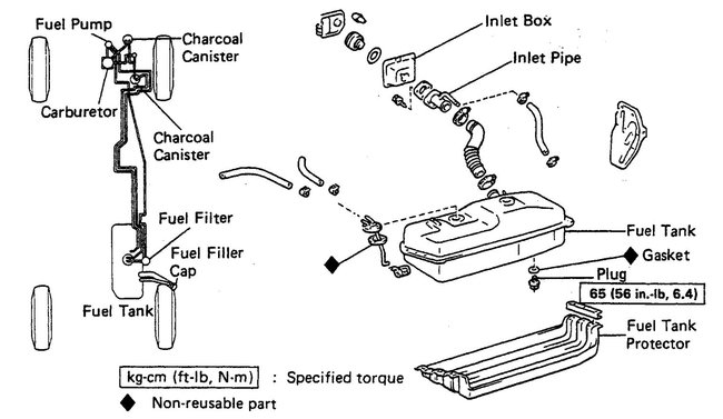

My father recently purchased a Toyota truck, can you tell me where the fuel filter is

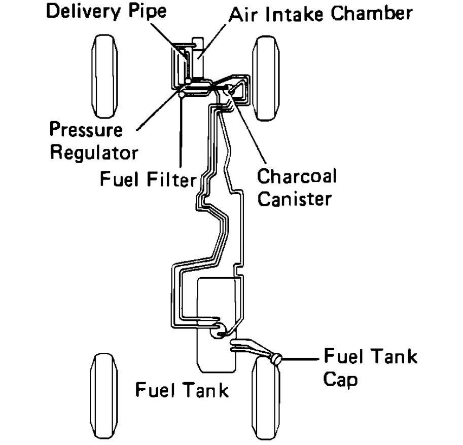

That will depend on the engine. That year has both fuel injection(22RE) and carburetors(22R).
22R- filter is located at the tank
22RE- You wont like this one. Under the intake/above the starter on the passenger side of the engine
Attached below you will find locations for both

HIGHROLLER45
  • 1987 TOYOTA PICKUP
Engine Performance problem
1987 Toyota Pickup 4 cyl Four Wheel Drive Manual
Were is the fuel filter located on the carburated 22r motor

Could be near the gas tank or follow the fuel line from the carbuerator towards the rear-

If your car is a carby version, there should be a filter inside the chassis rail near the filler neck.

I need to know where the fuel pressure regulator is and where the gas lines go from tank to what first second and third to return. Please.

' ave drawings for fuel lines, the regulator may be on fuel rail on engine there may be two lines going to rail usually a larger line is for feed and smaller line for return. If there is a line like 3/16" or so that may go to evap canister fro m tank.

Its located under the intake manifold might have to remove the starter.

Carb system its either near the gas tank or in the engine compartment. EFI system its under the intake manifold.
