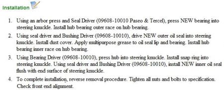

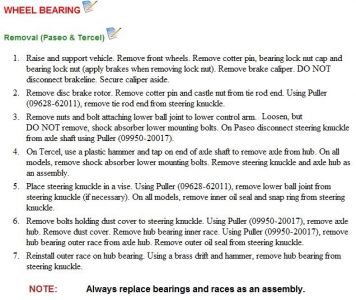

How do I replace the front wheel bearings on my 1992 Toyota Paseo?

BLUELIGHTNIN6
MECHANIC
16,542 POSTS
Monday, March 29th, 2010 AT 4:31 PM
