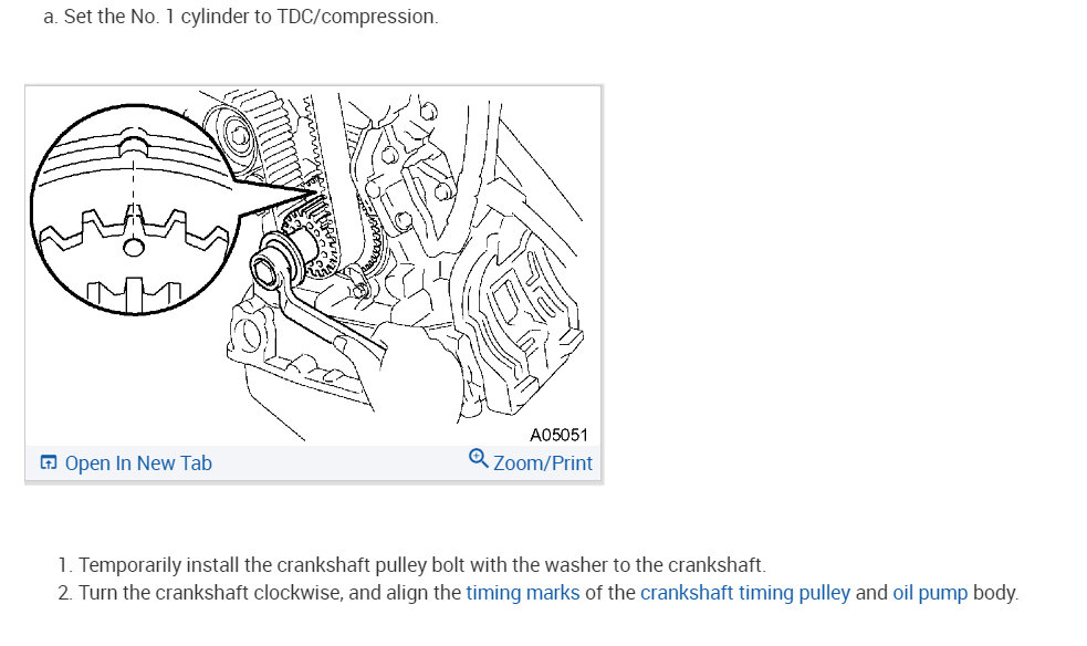

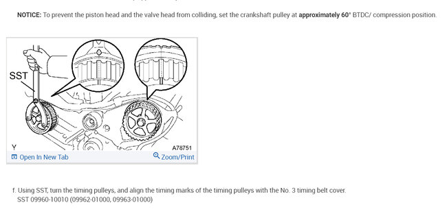

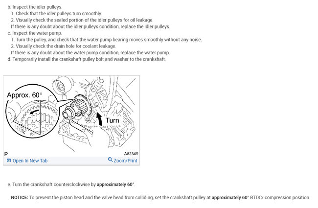

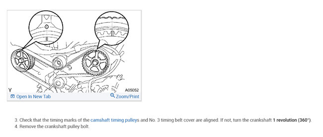

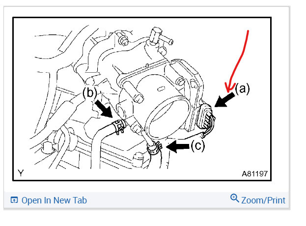

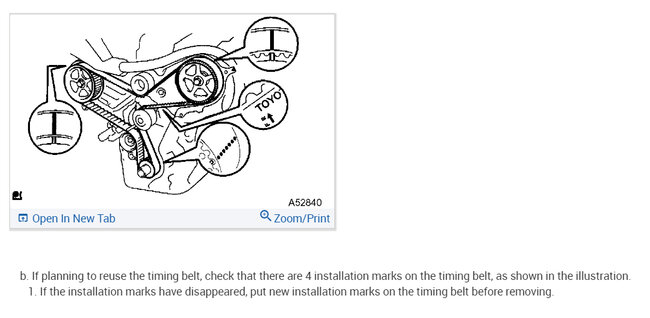

I would double check the timing belts marks and make sure the throttle body is plugged in. I have included the timing marks in the images below so we can be on the same page.
P2135: This code refers to a throttle/pedal position sensor/switch "A" / "B" voltage correlation problem.
P0121: This code is associated with the throttle/pedal position sensor/switch "A" circuit range/performance problem.
P0123: This code relates to the throttle/pedal position sensor/switch "A" circuit high input problem.
P0016: This code is specific to the camshaft position sensor correlation problem between the bank 1 sensor A and crankshaft position sensor.
