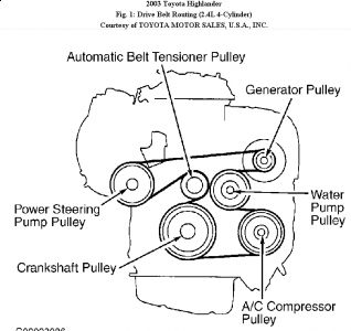

I need a diagram to route the serpentine belt?
Jul 7, 2009 at 11:29 AM
MERLIN2021
  • CAR REPAIR CONTRIBUTOR
  • 17,250 POSTS
Hello, Here is a diagrams below to show you the routing and a guide to walk you through the steps of changing it out.
https://images.2carpros.com/forum/automotive_pictures/62217_highlander_1.jpg
https://www.2carpros.com/articles/replace-serpentine-belt Please let us know if you need anything else to get the problem fixed.
