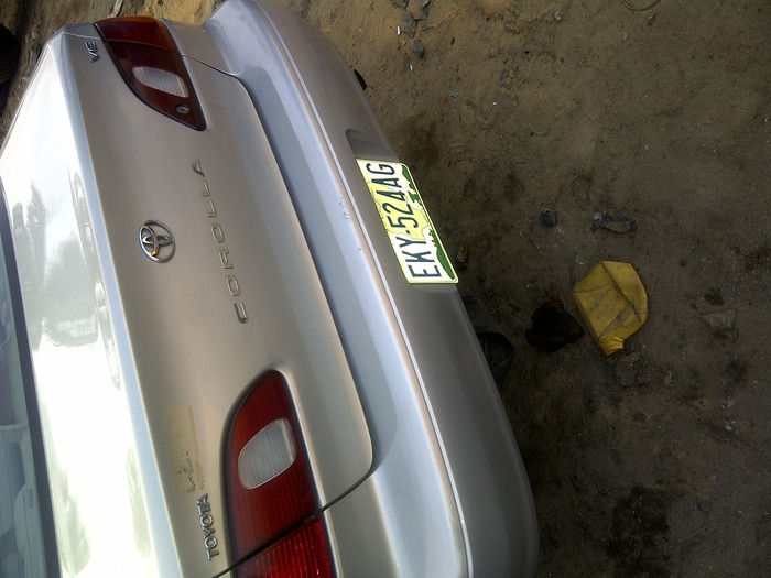

OLUWAKEMI
  • 1998 TOYOTA COROLLA
  • 130,000 MILES
Sometimes when its cold, its works for like 10minutes before it goes off. Have serviced the injector, nozzles and have changed the fuel pump, plugs and fuses. The battery and engine was changed 6months back.
