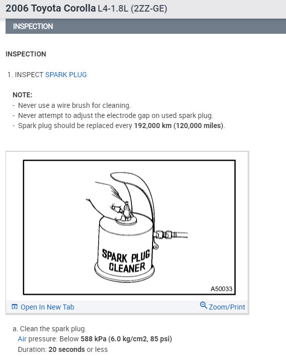

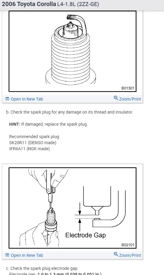

In order to replace the spark plugs, first you will have to remove the black plastic engine cover.
This will expose the top of the engine and you will see the ignition coils on the top.
The spark plugs can be accessed by removing the coils.
Here is a helpful vide that shows exactly what to do:
https://youtu.be/jvWqrAFQQmg
The spark plugs should be torqued at 13 ft.lb.
