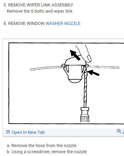

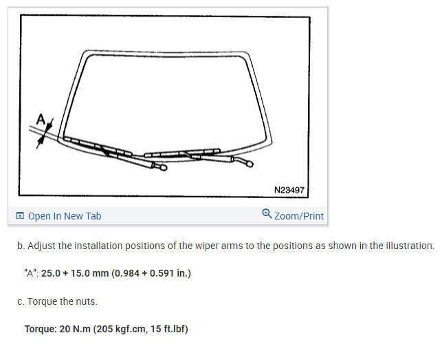

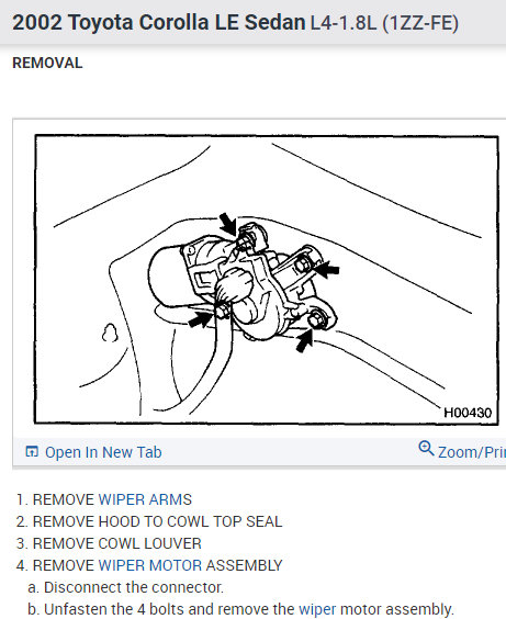

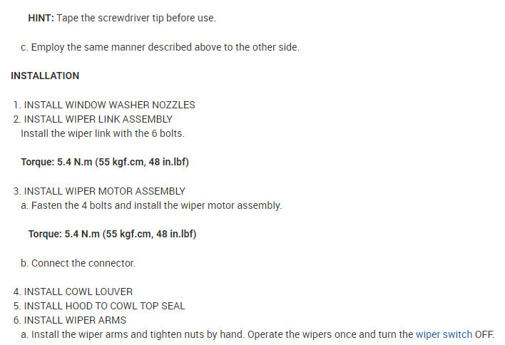

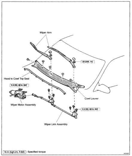

KYOSHIROSYN
2002 Corolla
having a similar, but different issue, the transmission linkage is the correct part 602-434 yet when i try to mount onto the motor it's not a match.
Jun 4, 2021 at 5:20 PM
DANNY L
  • CAR REPAIR CONTRIBUTOR
  • 5,648 POSTS
Hello, I'm Danny.
I've attached picture steps below on how to remove and replace the windshield wiper motor including the linkage on your Corolla. Hope this helps and thanks for using 2CarPros.
