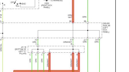

my left brake light does not work. i have replaced the bulb. the light in window above rear seat works, because i replaced switch under dash. should i follow the wiring system? where can i find a diagram layout?

Check the junction connector no.18 bottom of left C pillar or just just run another wire to the right side and splice in to green and white wire.
https://images.2carpros.com/forum/automotive_pictures/12900_brake1_2.jpg
