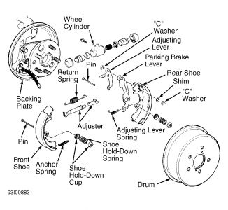

How do I change the rear brake shoes and is there a diagram can you help me please?

Hello, Yep doing the rear shoes can be a little tough. Here is a guide and video of a set of rear brake shoes being done. Most cars are the about the same for doing this job. Here is a guide that shows you what to do https://www.2carpros.com/articles/how-to-replace-rear-brake-shoes-and-drums Here is a video https://youtu.be/1j7qDoi1LP0 Here are some diagrams of what it will be like on your car.
https://images.2carpros.com/forum/automotive_pictures/61395_Graphic_77.jpg
More images (BELOW) Please let us know if you need anything else to get the problem fixed. Cheers, Ken
