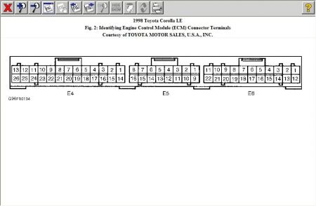

3. Access ECM behind glove box. Turn ignition on. Backprobing ECM connector, measure voltage between terminals No. 1 (Yellow wire) and No. 9 (Brown wire) at ECM E5 connector. See Fig. 2 . If voltage is 4.5-5.5 volts, go to next step. If voltage is not 4.5-5.5 volts, replace ECM.
4. Backprobing ECM connector, measure voltage between terminals No. 7 (Blue wire) and No. 9 (Brown wire) at ECM E5 connector. Disconnect vacuum hose from vapor pressure sensor. Sensor is located on top of charcoal canister under rear of vehicle, near fuel tank. Connect a vacuum pump to sensor. If voltage is 3.0-3.6 volts without vacuum applied and 1.3-2.1 volts with .59 in. Hg (2 kPa) applied, go to step 6). If voltage is not as specified, go to next step.

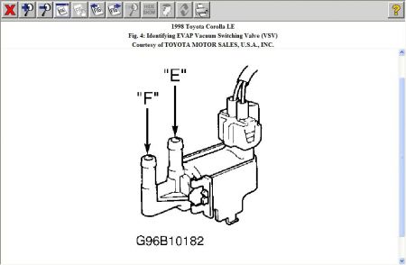

6. Disconnect EVAP VSV vacuum hoses. EVAP VSV is located near air filter housing. Apply air pressure to VSV port "E". See Fig. 4 . Air should not flow from port "F". Access ECM behind stereo on instrument panel, just in front of center console. Turn ignition on. Connect a jumper wire between ground and terminal No. 8 (Blue/Black wire) at ECM E4 connector. See Fig. 2 . Air should flow from port "F". If VSV functions as specified, go to step 9). If VSV does not function as specified, go to next step.
https://www.2carpros.com/forum/automotive_pictures/192750_VSVSensor98ToyotaCorolla01_1.jpg

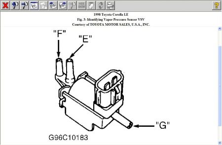

9. Disconnect vapor pressure sensor VSV vacuum hoses. VSV is located on charcoal canister under rear of vehicle, near fuel tank. Apply air pressure to VSV port "E". See Fig. 3 . Air should flow from port "G". Access ECM behind stereo on instrument panel, just in front of center console. Turn ignition on. Connect a jumper wire between ground and terminal No. 7 (Red wire) at ECM E4 connector. See Fig. 2 . Air should flow from port "F". If VSV does not function as specified, go to next step. If VSV functions as specified, go to step 12).
https://www.2carpros.com/forum/automotive_pictures/192750_VSVSensor98ToyotaCorolla_1.jpg
