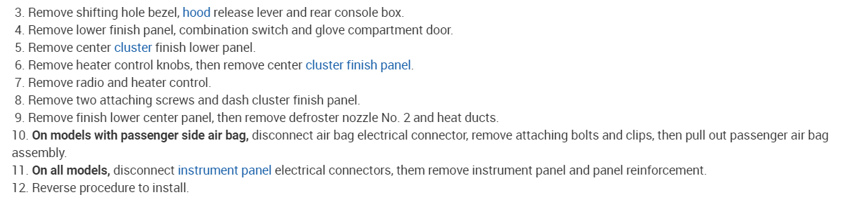

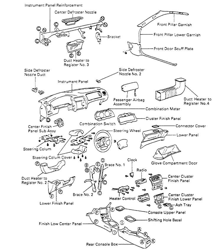

Hi tonyrlw,
The cluster needs to be replaced are diagrams to help. Check out the diagrams (Below). Please let us know what happens.
Sunday, June 15th, 2008 AT 11:37 AM
TONYRLW
Thanks for the advice I got a used cluster and everything started working. I love this site. Cost me $70.00

To remove the meter cluster, you need to remove trims etc.
Unplug the cable and wire connectors.
Is the speedometer working?
Did you check if the cable is broken?
