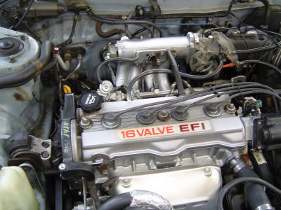

ANY contamination on the assy. belts can cause an intermittent screech, coolant, oil etc. does your engine look like this one?
https://www.2carpros.com/forum/automotive_pictures/108325_Picture_149_1.jpg
+1
Sunday, May 24th, 2009 AT 8:22 AM
JMEETOO
  • 8 POSTS
Hey sorry for the delayed response. I had the timing belt and all the oil seals replaced 5000 miles ago. Yes the picture does look exactly like my engine. It sounds more like an engine knocking sound as I work more and more on itor like something has broken apart and knocking around around in the motor. It sounds like its coming from the back of the engine. I'm kind of scared it might be a rod knocking, but it does it intermittenly. There was no signs of oil on the plugs. Is there a way to know for sure if its the rods making the knocking noise?
