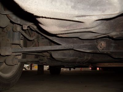

What exactly is this type of suspension? And I see the forward arm, it's slightly bent upwards, should I straighten that out?

Suspension used is Macpherson struts with link arms.
The radius rod tends to get bent when mistakenly used for jacking up the vehicle or when damaged by hitting potholes.
As the rod is bent, the alignment could be out causing abnormal tire wear. You need to get the alignment checked and adjusted after straightening it.

Thanks. Now I remember sometime one mechanic jacked my car on that side and that might have bent it. Thanks.
