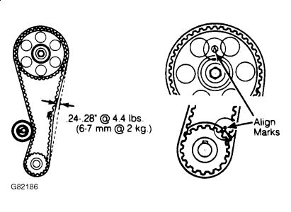

My mother has a 1989 Toyota Corolla with a 1.6L. We were wondering if anyone knew the vacuum hose schematics, what the timing belt should be set at and what is the torque for the head gasket bolts? I would appreciate any help.

Timing belt is installed straight up, i.E. Crankshaft pointing to mark on oil pump, camshaft belt cog hole is at 12:00, or camshaft timing marks pointing at each other (9:00-3:00).
If 4AFE engine or 4ALC then headbolt torque is 44 lb ft. Do in increments, 20-30-44 in sequence.
4AGE is 22lb ft. Then an additional 90 degrees and another 90 degrees.
Vacuun line routing should be on hood.

https://www.2carpros.com/forum/automotive_pictures/108325_1985_timing_2.jpg
This is 4AFE or 4ALC.
