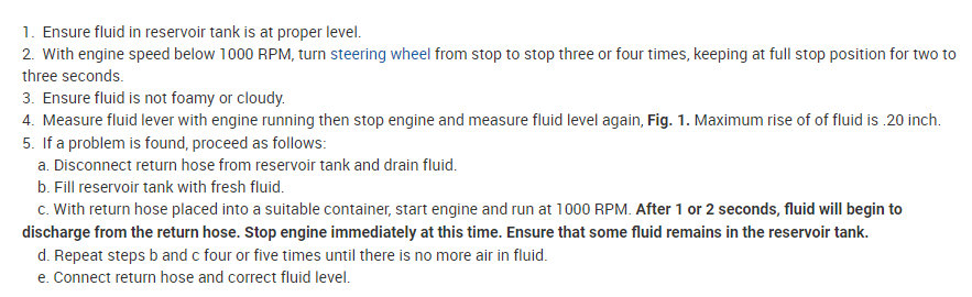

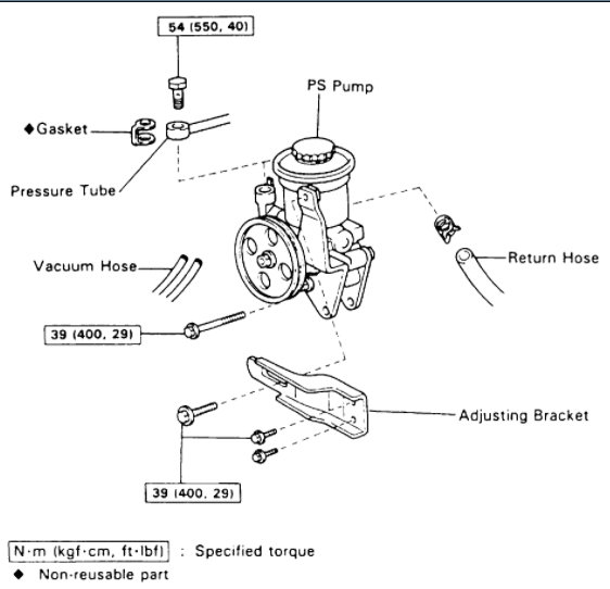

ii found the power steering fluid leaking under the car, i refill it and it continue to leak continually???
How do I replace the pump?
Aug 4, 2009 at 8:40 PM
DANNY L
  • 5,648 POSTS
Hello, I'm Danny.

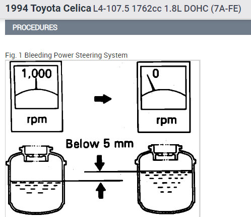

Here is the information you requested. Here is a tutorial for you to view on how to replace a power steering pump:
https://www.2carpros.com/articles/how-to-replace-a-power-steering-pump
I've attached picture steps below on how to remove and replace the power steering pump on your car. The last few steps are how to bleed the system when repair is completed. Hope this helps and thanks for using 2CarPros.
